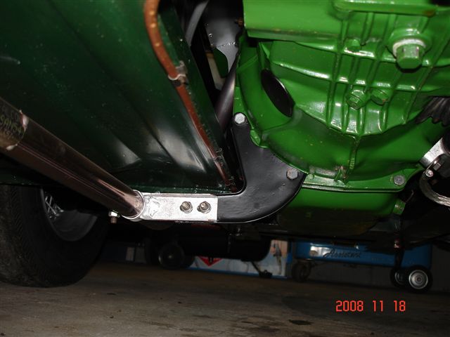

From what I've been told, the front clamp is very important. It stops the front part of the exhaust from swinging and swaying or twisting under torque. They had/have problems with the seal or flange breaking where the exhaust pipe joins the manifold. The bracket/clamp is there to make sure the pipe and engine/transmission move together. That is why it's connected to the bell housing and not the chassis like other clamps.
Picture is of a 948-1098 set up on a friend's car. The smooth case clamp is the same, but doesn't have the cutout for the transmission rib.
