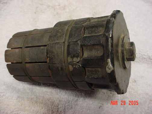

I had to remove my one year old exhaust (comes in sections). I used clamps to attach the parts before. They crimped the pipes. Now I cannot get them back together. Is there a tool to expand the outer-larger pipe to allow it to slip on again?

Yes, see the attached pic for one version of the tool.
If you use the band type of clamps as sold by Denis Welch & others, the pipe will not be crimped & it still holds very well.
