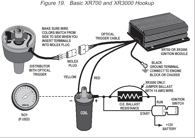

Coil HT wire? The coil has... two wires going to the XR700, one for the tach, two leading to the ballast.
https://www.cranecams.com/pdf/90002000a.pdf
Pic attached... So no HT lead, right? Leaving coil (checked) cap or rotor, or XR700?

ummm... Duncan, th' "HT" wire is th' BIG FAT one to th' centre of th' cap, lad. "High Tension"
Aaaaaaaah. As in, comes with spark plug wires? Gotcha. I have three, and I believe the stutter is present with all three. Will double-check tho.

Which wire do you have running to the coil (+) terminal? There are several to choose from on a 1500 retrofit. One is a white wire with a green stripe. This wire connects to a loooooong wire that is buried in the harness. The long wire acts as a built in ballast for the coil. So if you had the white/green wire running into an external ballast and then into your coil, you could be starving your sparky box for juice.
Just one a them wild guess things.
Here's another... is your fuel pump still running off of the ignition circuit? That could be creating some "noise" or draw down in the line that is making Mr. Sparky unhappy.
I believe the two wires feeding into the ballast are white and white / grn. I'll check in the light of day.
