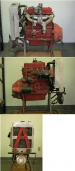

Here is a really simple one I got with the free A series motor. Only thing it needs is gauges.
That is charming! I dig old custom tools like this. Yeah, I would flesh that out with the goods and use it.
