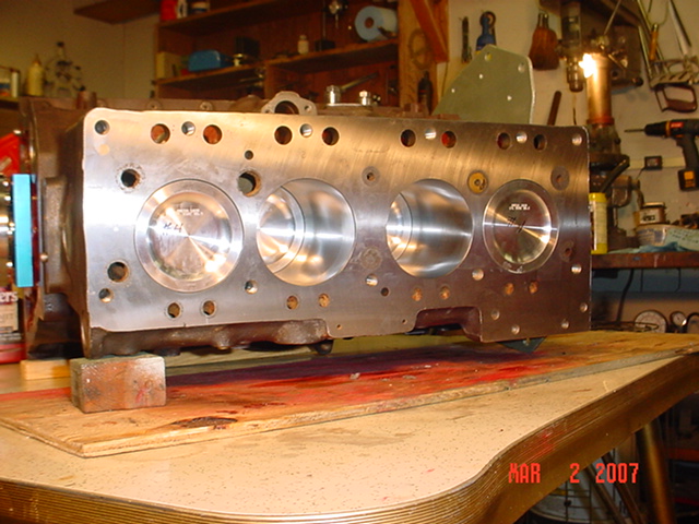

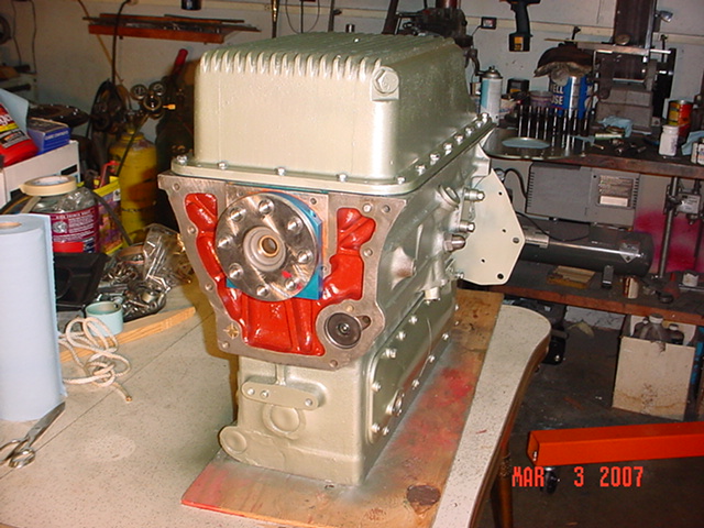

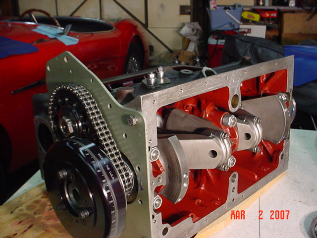

I have had several engine stands & many adapters over the years. Gave them all away. I may be old fashioned, but I prefer a sturdy kitchen table to work on. lot less fooling around & more flexibility on positioning the parts for access to various areas & a lot more stable. See pics.
D

Dave you're building you a whooper there aren't you buddy, a Fardon billet crank and Carrillo rods. I still perfer a engine stand though, I make side adaper for mine, so I can bolt on the back palte and clutch while on the stand. Here's a picture of my side adapter for a MGB, and A series, I also have one for a Spitfire/1500 Midget motors.
Pretty Engine Dave! Is there any reason other than asthetics for painting the inside? - sure looks nice
Hap - no link to your piece - I'd love to see it
Hap I'd love to see your 1500 adapter.
JP,
The inside is painted with "Glyptal". Mainly used as an electrical insulating varnish.
Some engine builders use it to seal the pores on the inside of blocks & rough cast surfaces. Removes places for contamination to stick & promotes faster drain back of the oil.
My block was originally done this way by the factory. The original was still on the insides after 50 years. The hot tank removed it so I just put it back like it was.
D
Dave,
It sure is pretty.
Dave Russell said:
JP,
D
Dave - I'm getting my Midget engine back from the machine shop & am interested in doing that to it.....any tyips other than buying Glyptal & putting it on with a brush? & where can I get Glyptal?
I got Glyptal from Eastwood. #46001ZP, brush on, one qt. It's "Glyptal #1201 Red Enamel (Insulating Paint)". Other sources may have it also.
The metal needs to be clean. Thoroughly wash down with lacquer thinner, brake cleaner, or?
D
Thanks - engine will be real clean coming from machine shop but I'll wipe it down again.

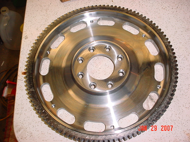

The stock crank is redlined at 4,800 rpm, & is known to have a destructive harmonic at 5,200 rpm. Since I wanted reliable operation to 6,000 plus rpm, Better crank, rods, & pistons were needed. The 13 pound 8 bolt steel flywheel goes with the combination. See pic.
Combined with the DWR aluminum head, header, 9.8 compression, cam, & H6 carbs it runs pretty strong with no fear of "exploding".
D
