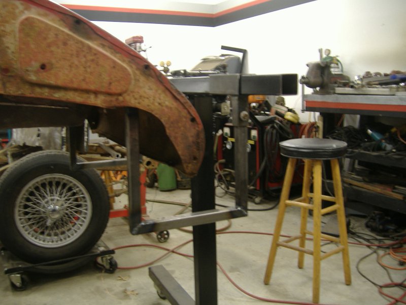

I designed my own rotisserie, but used a slip on adaptor arm design which can be changed for any body I need to mount. Here is the arm design for my MGA body which mounts to the body mounting locations front and rear. For my Midget I'll mount to the front frame horns and to the rear spring hanger points. The arms are built to enable access to the rear panels for body work so don't fit too close to the panel. More information at https://www.britishv8.org/Articles/Auto-Body-Rotisserie.htm
