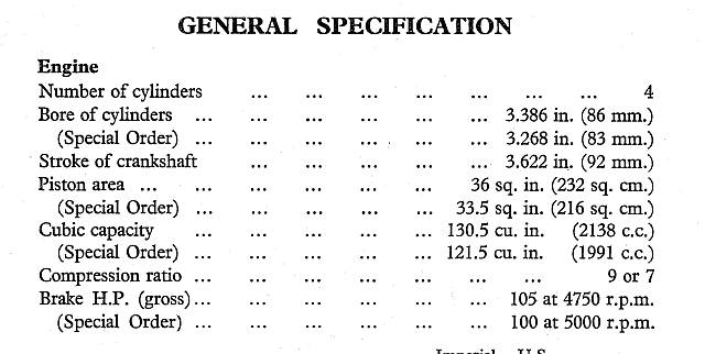

This is from Practical Hints, 6th edition. I'm not positive exactly when this was published (no date given), but it does not show Lucar connectors on the control & fuse boxes, while it does show the split steering column, later carb setup, etc. So I believe it was published around 1959 or 60; long before the TR3B came out.
Interesting! I have to wonder if it was a typo or transposition of data, as that's the only "factory" or other literature I've ever seen indicating that, at any point before the 3B, the 2138cc engine was stock and the 1991cc engine was optional!

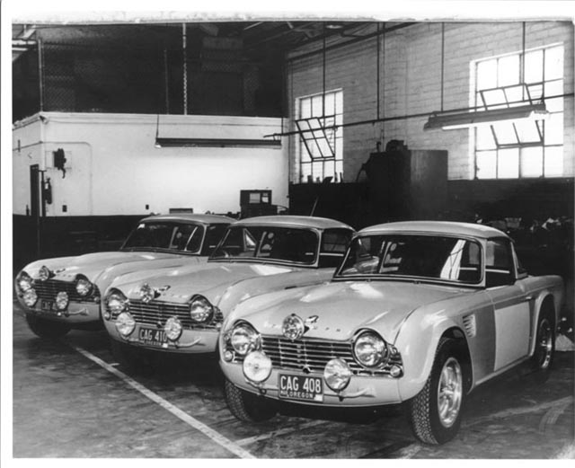

THe three powder blue TR4s that Kas prepered for the Shell Rally in 1964 had the 1991 cc engines because they wanted them to be in the class under 2 liters. All the Falcons, Dodges and Plymouths were in the nezt class with V-8 engines built for muscle cars.
I did that rally in a Renault R-8
