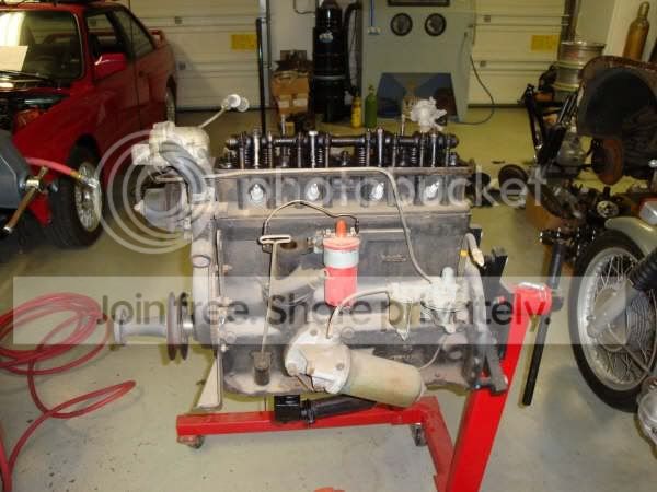

It will be pallet mounted, with side supports that we're planning to bolt on to the engine mounts. No exhaust manifold, but everything else you see will be there along with a valve cover.
I don't think it has the fly wheel still attached - but honestly I forgot to ask.
