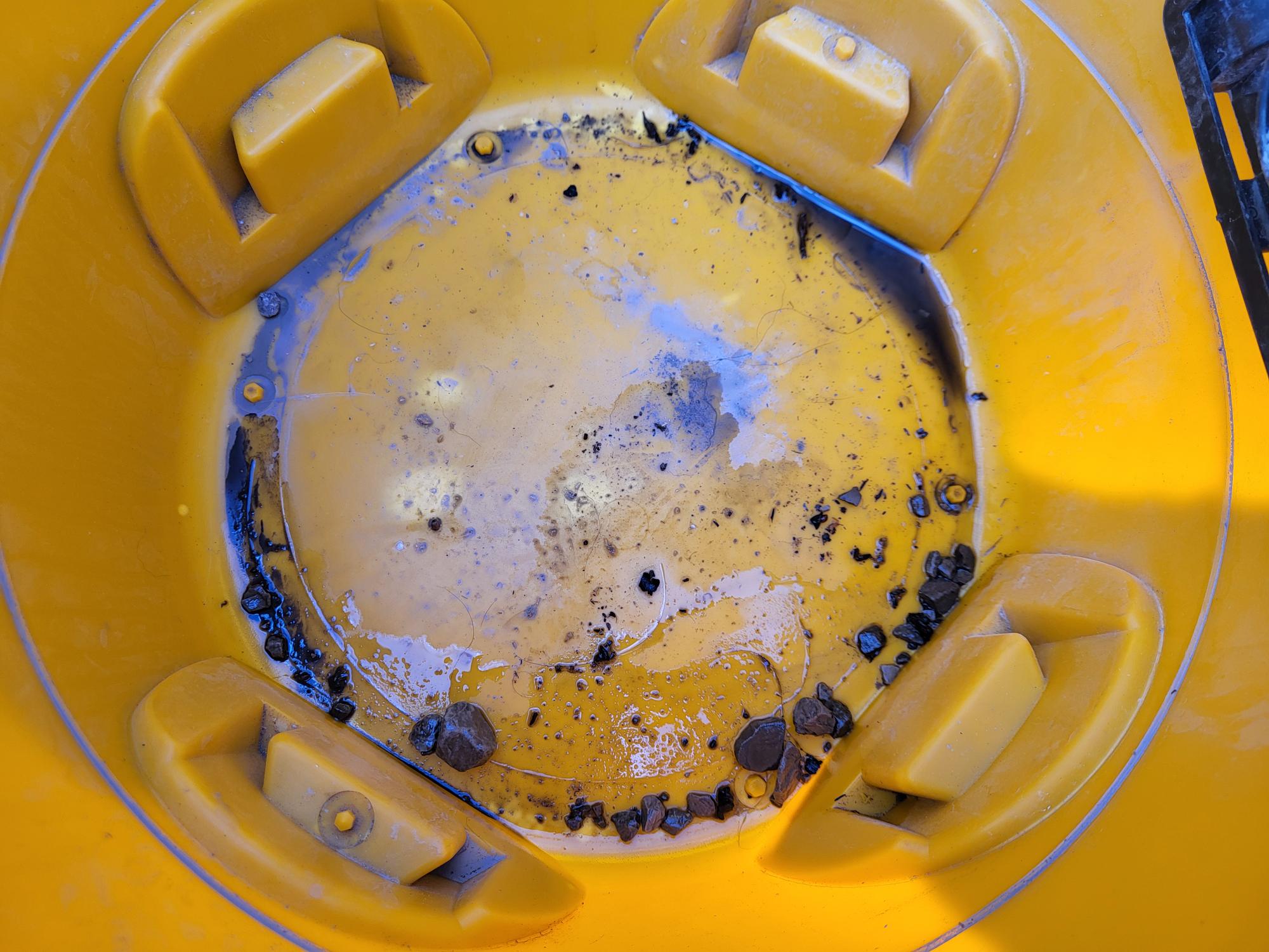

Removed gas tank and removed debris and gravel (See picture; I need a locking gas cap)
