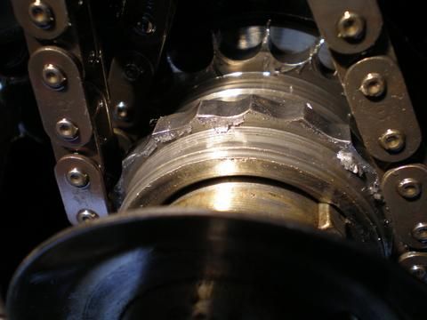

Obviously, my approach is a little different than most people on this forum. Far too often, brand new parts are defective (too weak, wrong materials, wrong size, etc.), while usually I know the old parts have served well for many years. If they are not worn close to the limits or otherwise damaged, I tend to reuse them. We've had long discussions (mostly on the Team.Net list) about defective parts, and IMO it would really suck to have a motor trashed because some stupid new part was wrong.
This photo is of a buddy's Stag motor, with only some 7000 miles on the rebuild. He was not a happy camper!

What I don't have are photos of the new clutches that have broken, fuel pumps that came apart and took out the camshaft, oil pumps where the rotor slipped on the shaft (starving the bearings), etc. But I have heard the stories!
