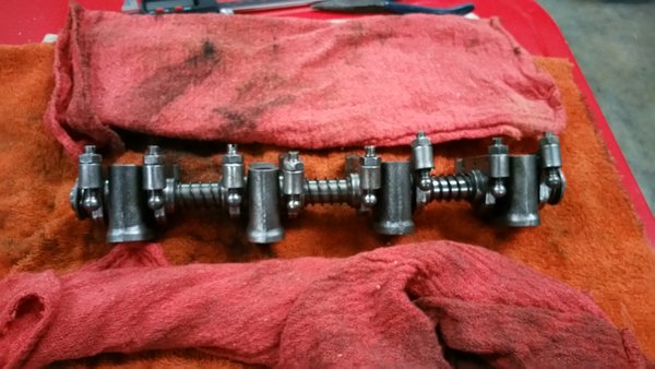

Here is a photo of a cleaned up rocker assembly:
Cleaned up Rocker Assembly
