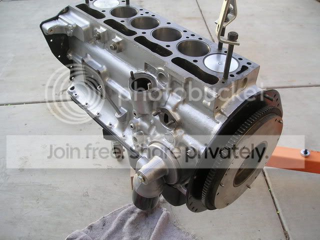

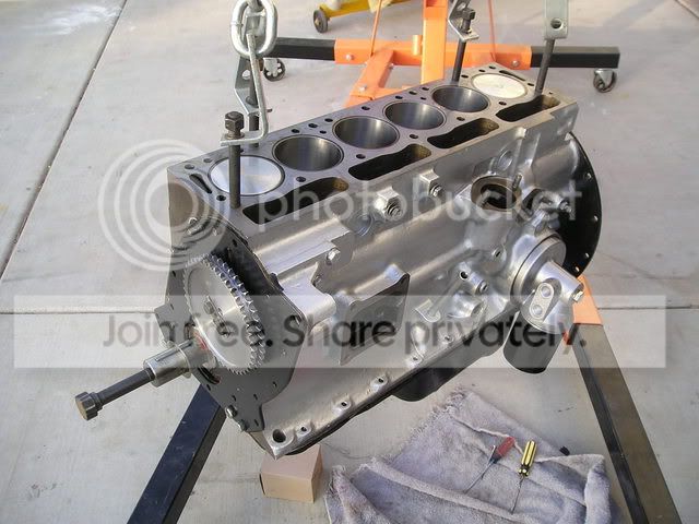

Here you can see, again, pistons 1 and 6 at top dead
center. The cam gear is in place but will have to be pulled,
of course, later for proper setting.
No crank gear on the crank as putting it on and off is
a bit more headache and only hope to do this once more, if
my measuements are correct, when spacers arrive.
Notice that I have installed the after-market oil filter
spin-on type upgrade. I'll show another picture that will
demonstrate how turning the oil filter adapter a bit to
the front of the engine is a good idea as it will provide
a bit more working room when changing the oil filter, once
the engine is installed:

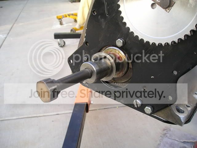

I show in the next picture the large bolt in the end of the
crank; the crank itself and then about mid-way back of the
crank toward the engine block is the very fine spacer/shim
I await in the mail.
This particular one is one in which I notched the inside
of the spacer so that I could slide it onto the crank and
all the way back to the engine block, where it will reside,
without removing the wood ruff from its slot in the crank.
(Stole the idea from small block Chevy OEM's).
So I guess I have to chill untill the parts come in.
Come on Mosssssssss. Ju kan do it!
Also, I thought I might also comment that if you look
at the very back of the engine, you see in the flywheel
a number of holes. Not all of those are factory-type;
a good number of them were drilled for nothing more than
balancing the engine; making that thing's weight
even from one side to the next so she turns more
smoothly and true...expecially when you tromp down
on the pedal....heh, heh, heh.
Thanks to my machinist.
Looks great Dennis!
Now you'll be prepared to do mine.
- Doug
2
absolutely superb. It's a shame to eventually hide it in the engine bay. Good choice of colour too........
Regards
Craig
Excellent work! Your progress is laudable.
Notching the spacers is a viable bodge, too. Makes NO difference to their function.
:thumbsup:
Looks great, I also like the color.
If the shop removed the oil galley plugs when they cleaned the block, check and make sure the ones that would be hidden behind the motor mounts are there. Easy to check now fun to put in later.
2W,
It looks really good. I wish I were that far along, but you are a few weeks ahead of me.
My crank got balanced today and the head is 90% complete.
Sigh............
Hopefully, line boring will begin tomorrow.
Someday, I'll actually have mine looking like that.
But it will be red.....
My engine is in for a rebuild also, hope it looks that good when it's finished. Since I only have 4 cylinders it should only take 2/3rds as long to rebuild it! :wink:

I wish that you had a camera to record the look on my face as I read your post and saw this line; "I am waiting
for the spacers or shims that go behind the crank timing
chain gear in order to properly aling it with the cam
gear."
OH-OH!!!!
Guess who forgot to order some of these?????
Must call Moss first thing in AM!!
EDIT: Moss had them on stock in NJ. I'll have them by Friday. Hopefully the machine shop will need them by then.
