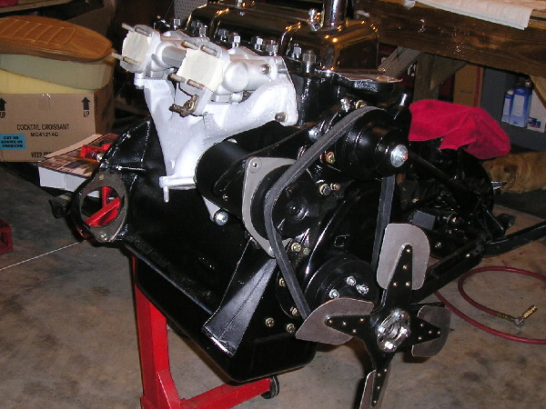

Couple of pictures of the engine. I'm ready to take it off the engine stand add the flywheel and the clutch and put on the frame. It will be really exciting to me to have it on the frame and can add the items that will turn it into an automobile.
I would kind of like to put the body on before the tranny and overdrive, just cause. Any technical problems with that? Also if I put the body on it will expand my shop by a considerable margin! I really could use the room.
Cheers, Tinkerman

Nice job Tinkerman!
I don't know about the TR3, as far as room goes.
My rule of thumb as that if you could build it on the stand and put it in as a unit, that was the way to go. Doesn't the front end open right up on those?
Spitfire opens all the way like the E type jags. TR's don't. I had to mount the engine using the bell housing when I mounted it on my stand. I will now suspend it from my A frame and add the flywheel, clutch stuff and starter, etc., before I put it on the frame.
Thanks for the thoughts.
Cheers, Tinkerman
Look really nice. The fan is a beauty!
If you mount the engine alone (w/o gear box), you will have to support the rear of the engine somehow and might make it hard to move the chassis around. The gearbox will go in a lot easier if the body is off and you can also get the drivershaft and exhaust lined up easier. But, up to you.
Nice job!!!!
One of the guys posted a picture of his TR3 with the front end wide open, with the grille out. Actually, it's at the shop where my car is right now and his engine and trans were pulled as a unit. I think that they were. I'll confirm later today when I go to see mine fire up.
Tinkerman, that engine looks great! I think I'll print out these pictures and show them to Erik and tell him this what I want my engine to look like when he's done! :thumbsup:

No apologies necessary! Seeing all these terrific engines, Tinkerman's, 2Wrench’s, yours has me itching to see mine all done! I hope Erik thought to take a couple of shots (I didn’t think ask him) of my greasy dirty engine before he started to take it apart. That would be nice to have some before and after of it.
Tinkerman's engine looks like it just came from the factory!
Hi Paul, yep, once again I was thinking in one dimension while you and others were thinking in three dimensions. The front of my body tub looks just like Rich's does, so to that extent it does open right up. However rational thinking dictates that it would be much easier to drop the engine, tranny and OD in without the body tub being on the frame.

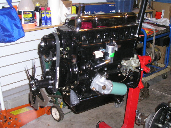

Thanks all of you for your kind words about the engine. I hope that all of you twigged to clicking on the 2nd file listed on the post to see the right side of the engine. Don't know why it did that, curious.
Cheers, Tinkerman
I'm glad you pointed out the right side picture, I was looking at the wrong side, but both sides look great. And the little bit of the frame showing looks just as fantastik.
Excellent work. Sometimes I feel like I'm taking too much time on mine and trying to make it too perfect, then you guys submit your pictures and make me think I'm not doing such a good job.
Tinker, that sucker looks great! Youch. Really,
really happy for ya.
