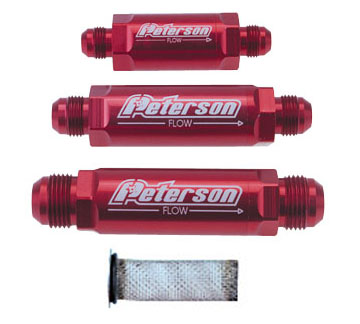

If you useing a traditional B series oiling system routing, meaning going to the cooler unfiltered, you may consider putting AN inline screen filter on the line to the cooler.
Something like this, alot of folks use them on dry sump oiling systems to protect the dry sump pump. I have a customer preparing a MGB for vintage, and plans on using the inverted stock MGB oil filter housing and I've recommended he install one of these on the oil exit line and before the oil cooler.
Hap--
Great suggestion. I didn't mention in my earlier posts but I have some space constraints that would make it very difficult to install the usual free-standing cannister filter (System 1, etc) into the supply loop in a place that could be easily serviced. However the inline filter would work well for me and I'll look into ordering one tonight. Would you recommend removing and backflushing it with each oil and spin-on filter change?
