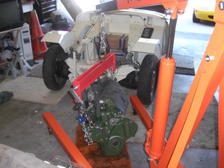

I have never used the engine lifting brackets before. I think they would just bolt onto two of the head studs - sound correct?
Kevin
I used the left rear exhaust manifold bolt (replaced it another one in case it bent) and one of the big bolts that mount the generator adjustment arm. I used a leveler which made it almost too easy, one man job!
Scott in CA
That's the ticket Scott. easy job for sure. Just a PITA when you wind up doing it seven times over a two year period.
