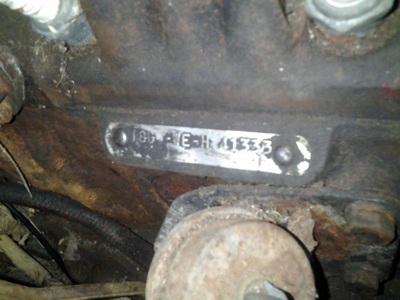

I'm looking for an engine and found one in MS, but it's a long haul and started looking closer. Found a GT rust bucket with this engine, but no letter after the 18G. Engines I've seen from the 68-71 timeframe have always had an 18GH, GK, etc...what year would you think this one was born?

The "WE" would indicate it is a 4-syncro engine, so '68 - '71. Somehow there is a letter missing after that first G. Strange. What year GT?

Thanks, it is listed as a 72 so it could easily be a 71...the 'missing' letter confused me and I asked for a picture in case I heard wrong. I'm fishing for an early 18V with forged crank, straight cut con rods, etc., AND an OD tranny!

That is probably a GK series. The 2nd letter is very faint on some of the GKs I have had and stamped different. The later GK series had the straight rods with a full float wristpin (ie circlips) I think the early GK may have been side split rods. Worth checking in Clausingers original MG book. Its not a 72 MGB because it has the electric oil pressure sender on the block.

Thanks, I was checking with Clausager and that's why I was confused...the owner gave me the engine number and then sent a picture since I requested it, but he can find nothing after the G, stamped or scratched. My guess is a late 70 block because of the oil pressure sender, but I've still got questions. I have a GH in my B, mfg in March, 1970.

I have engine 18GH-WE-H26450. All of the letters/numbers are stamped from the inside out except the 'H' which is stamped from the outside in. The 18GF and 18GK engines I have are all stamped from the inside out. I'm guessing an 18GH.
As the memory fades....Alan in Atlanta is correct. GH is the odd stamped engine plates. Alan, We need to get together for lunch soon! Bob
I found two more 18GH engines where the 'H' is stamped from the inside like the rest of the figures. And yeah,Bob,it's been a while. I'll let you know if I'm in NC anytime soon.
Alan
On my 71 GT, the engine is an 18GJ series. On mine, the J is stamped from the opposite side of the ID plate than the rest of the numerals.
