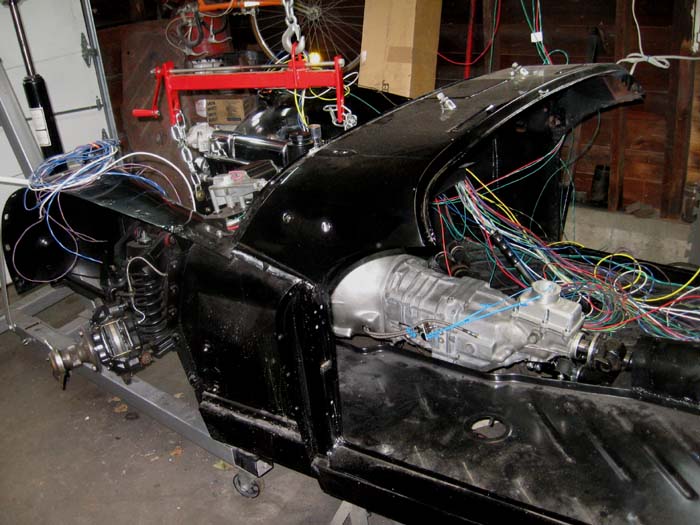

I had my son come over this morning and we mated up the trans to the engine and proceeded to stuff both in the TR3 resto project. This is a nice milestone. Everything went really well, including the mounting of Herman's (HVDA) Toyota conversion. It all lined up beautifully and went in slick as greased lightning. We celebrated with a Sierra Pale Ale! :thumbsup:
Edit: Boy, that's a pretty lousey picture! :sick: Yeah, that's Dan Master's wiring laying all over the place. His harness is alot of work, but I impressed with the quality and thought that went into the kit. Besides, it's a great way to bond with the car and it's electrics.

Art,
I salute your efforts and offer a toast of a nice cup of hot tea to you and your son. It's rather cold and damp here, so I'm warming up reading the posts of the day.
And congratulations!!
How about a few more pictures from other angles?

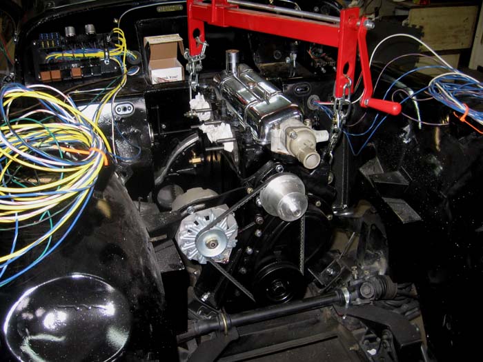

Here's one from the front...

That looks really good. Is that a Dan Masters harness? It looks like some nice heavy gauge wiring you have there.
Yeah, I have the Dan Master's wiring harness. Most of the wires are 12 gauge. A couple of 14's that operate the relays, and 8 gauge for the alternator to the main feed. Nice stuff, properly sized, but alot of work. I'm taking it in small bites and am starting to see progress. :yesnod:
Best way to do it, Art. Get a few connectors hooked up and it will start to look like a running car again, then you'll begin to fly through it.
