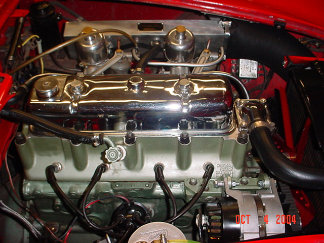

If you have side draft carbs It's pretty easy to do. Here is a pic of the A-H BN2 factory cold air intake.
The box is 4" by 2" & connects to a 4" diameter hose. The H6 carb float chamber vents are connected to the box for pressure balance. The front end of the hose is connected to a high flow K&N conical filter just behind the grill.
