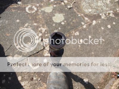

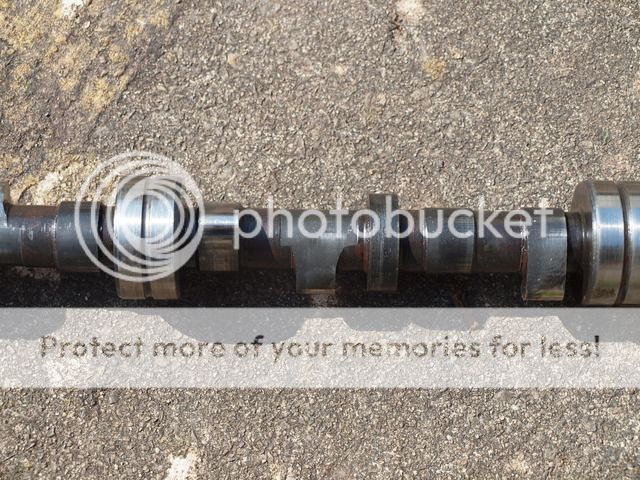

He seems to have finally got to a stage where we can identify the camshaft: appears to be a 643/544 profile on an unmarked camshaft with a spider drive.

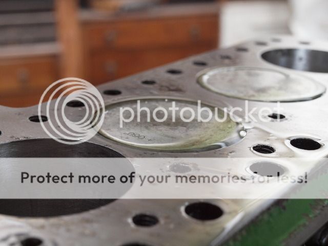

948 + 60
Hepolite 18519 flat top pistons
Fully balanced and lighted
12g295 head (current CR 8.5)
2xhs2

b) the block only has the single cam bearing...should we look at getting it line bored? machine shop that had it in for cleaning and decking felt the bearing and block looked fine...
but its obviously had some work at the crank needed sorting and one of the conrods needed straightening.....

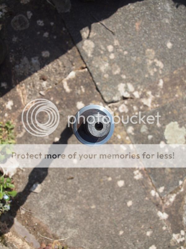

Which match closely to the C-AEG-643 in vizzards book. it has 1/2inch lobes. But no markings apart from possibly an A? (see pictures) on the end.
Also the recession of the lobes show in the photos below, is that normal?!

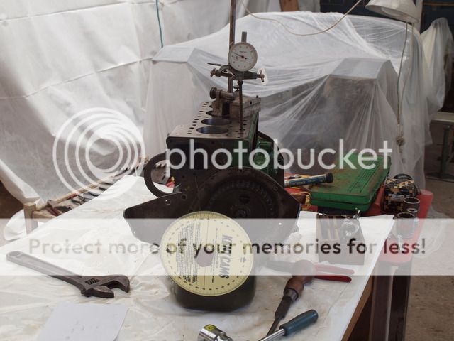

The equipment in use...probably as old as the car :laugh:
