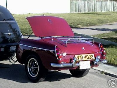

Here is an idea for what to do with the old shell rather than just junk it. :iagree:

fogliner said:
Yes,probably the best course of action as you say.
I rather like this suggestion! I'd take the old shell, merge it with a small pop-up camper and Bob's-your-uncle! :laugh:
