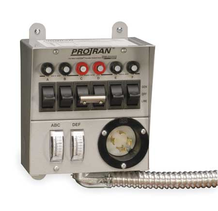

This has been my go to set up for the customer who wants the security of a backup generator without spending a lot of money. It's easy to install and foolproof to use. This also lets you store the generator or use it somewhere else. Simply plug in the cord start it up and flip the switches. https://www.zoro.com/reliance-manual-transfer-switch-60a-125250v- 30216a/i/G1575594/?utm_source=Bing&utm_medium=cpc&utm_campaign=PLA
attachment.php

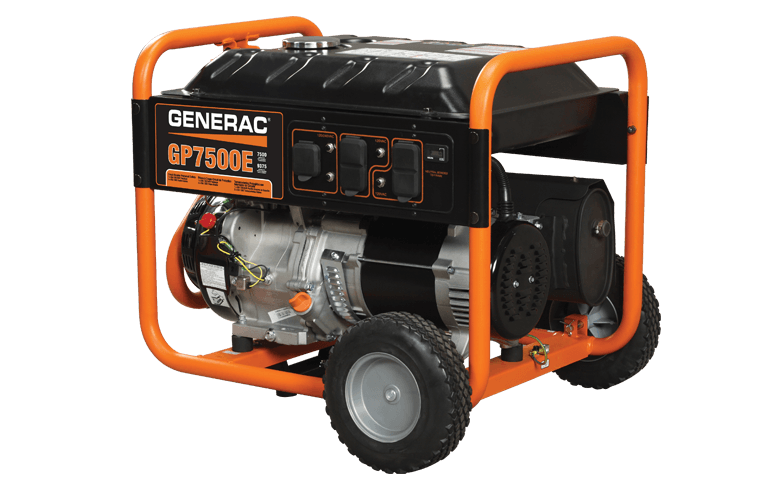

Bit the bullet this week. Manual transfer switch is installed outside by the electric service entrance panel, and placed an order for this one - found it on sale through Amazon:
attachment.php
Thanks for all the input and advice!
Mickey, No picture is coming up. PJ
Nice choice Mickey, they have a good reputation. :encouragement:
