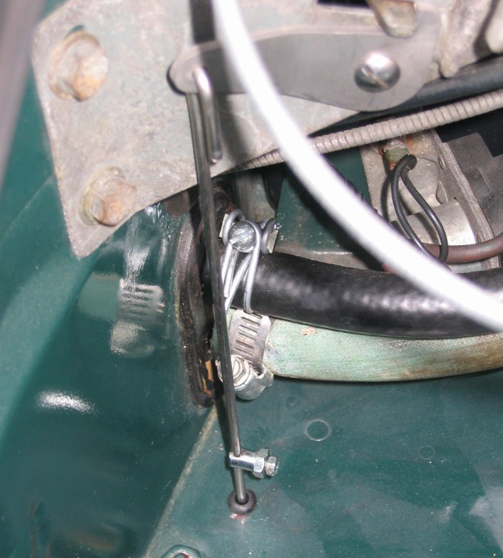

Howdy all!
Here's a photo of what I did to prevent it from being pulled too far down and getting jammed. I used a spare cable stop -- I had to drill it out to fit the rod. I tested it all afternoon, and thus far it won't jam or interfere with the operation of the regular hood release. I'm very pleased!
Thanks for all the suggestions!
Looks good. You got the lever clearance pretty tight, too, I see. Mine is just like yours, except I put a spring below the clamp to keep pressure heading back up. I may like yours better, though. Less "stuff."
[ QUOTE ]
Interesting hoses ...
[/ QUOTE ]
/ubbthreads/images/graemlins/lol.gif I'm gradually replacing all the hoses with a new set -- I assume the bottom hose was the green TR6 color. You should have seen the original, 38-year old hose that the black one in the photo replaced -- it had the yellow stripes and all, and still held water without leaks! However, I replaced it when the new heater valve went in.
