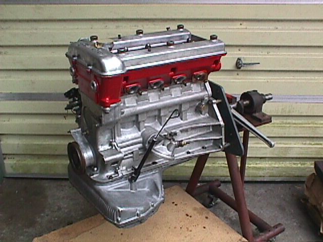

I replaced the tired 2.0L with it in 2000:
perty
And she is a Red Head too. Cool
That was as a joke. Homage to Shankle more than its Ferrari cousins.
Unfortunately the red paint has pretty much flaked away by now. :frown:
Nahh. The Lotus T/C is a "business machine". Simple and gets th' job done. :thumbsup:
