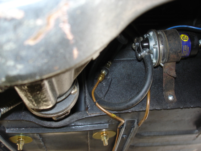

I agree. Over the rear axle. That's where mine was before unfortunate accident. See attachment.
Mine as well.
Thanks for the input guys. Kcbugeye - thanks for the picture - that's about where I was figuring on mounting the pump.
