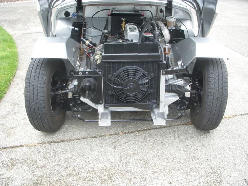

What a coincedence. I just installed or as I should say had installed a 9 inch fan on my Bugeye with a 1275 yesterday. The fan is perfect as I can still keep the safety rod for the bonnet with a very slight bend of the rod.The switch to operate it was installed under the dash below the W switch for the windshield Wipers. The switch is completely out of sight, but easy to push to turn on the fan and pull to turn off. It also is very quiet. The radiator was pulled to make it easier to attach the fan. The fan that I got was recommended by Bill M. You also will have no trouble with the bonnet scraping the fan when you lift or put the bonnet down. I had a larger fan on my previous Bugeye and it was very loud. like I say this one is very quiet.
The fan was $24.95 with free shipping and no sales tax. The fan came on a Monday and I ordered it the previous Thursday.

I like this 9" fan (Bill's above) because it has about 1/4" clearance on the Bugeye (about 1/2" more clearance than the 10" ) AND it can be installed on the box nose cars without removing the radiator (thru the grill)
This (9" fan) is installed as an AUXILIARY fan, not the primary one- it would not be big enough as the only fan in the system
