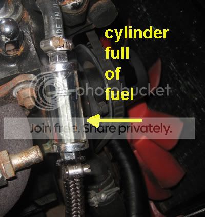

Hoses? Yes, every hose is brand spanking new-front and rear.
The steel line running thru the frame is NOT new but I flushed
it with gasoline and blew an entire can of carb cleaner thru it.
I tested it under pressure of 5 gallons in the tank.
Gasoline gushed out, so I'm real sure no clogs.
Plus I took the carbs off and cleaned the bowls. etc.
The car ran great with everything new and then quite
suddenly when the better than new, mechanical pump quit
pumping gasoline when Ian was driving in the hood.
About 110 miles total on the replacement fuel delivery system.
I'm still working on the first ten gallons of high test fuel.
So I doubt ethanol is the culprit but you never know.
I'll keep at it and report back in a part three.
thanks everyone for the input.
dale
