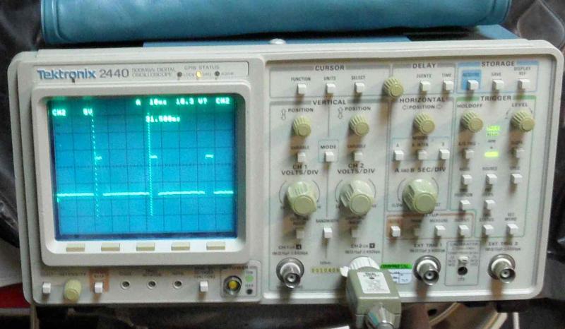

OK, I'll bite. Here's a picture of my scope with a regular old 10x voltage probe attached to the minus side of the coil, +12v on plus side. I'm using a crane ignition and negative ground. What kind of probe are you using and where is it attached? RPM is 30/t making your idle about 1,000RPM. All I see is the engine speed.

Close, it's a 1965 scope, so older than yours, but only 1 decade newer than the car. I have a nicer, newer scope I'm bringing back to life. Maybe it'll photograph better and I can have a scope diagnosis thread. I am just really floored that these scopes can be picked up for pretty much the cost of shipping, and they are just as relevant today as they were when they were made (40-50 years ago).
Reading off the coil primary can diagnose all the primary issues. Taking it off the secondary adds in all the secondary issues too. This is the probe I bought:

I got a couple probes, so I use one to trigger on the #1 plug wire. The other pulls the trace off the coil wire. So channel 1 is the trigger and the photo is of channel 2 firing pulses. All I learned for now is the 2 is running great. Now I have to wait for it to act up to try those diagnosis skills from Steve's teacher!

Hmm, your scope is older than I thought. I didn't know they started putting values on the screen that early. The ebay description of your probes is almost understandable. 'Techy' speak is difficult when spoken (or written) by someone who actually speaks English, let alone someone who doesn't.
So, if your probe is AC coupled at 100mV/div and the probe is x10,000 your reading a spark voltage of roughly 1,500v peak?
