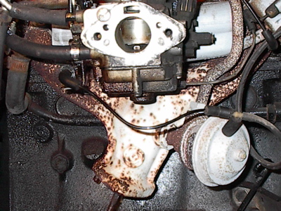

Which block plug? I see 2 plugs near the fuel pump. Either one?
Nope neither of those. The engine drain plug is on the carb side, left of where the exhaust manifold attaches to the tailpipe (see attached).
