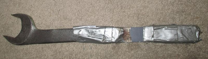

Steve, the tool that I made to rotate the engine with the dog nut is shown in the attachment. Not very elegant, but it does the job. I found the basic wrench in an antique store (lots of antique stores have these old tools). I cut the spanner off the other end and welded on an extension for easier turning of the engine. I had to file the jaws slightly to make the wrench fit the dog nut. The wrap of tape in the middle is to pad the wrench from hitting against the waterpump, and the tape on the end is padding for my hand. The measurement across the flats of the wrench is 1-7/8". A socket won't work because the frame front cross-member is in the way of getting a socket on the nut.

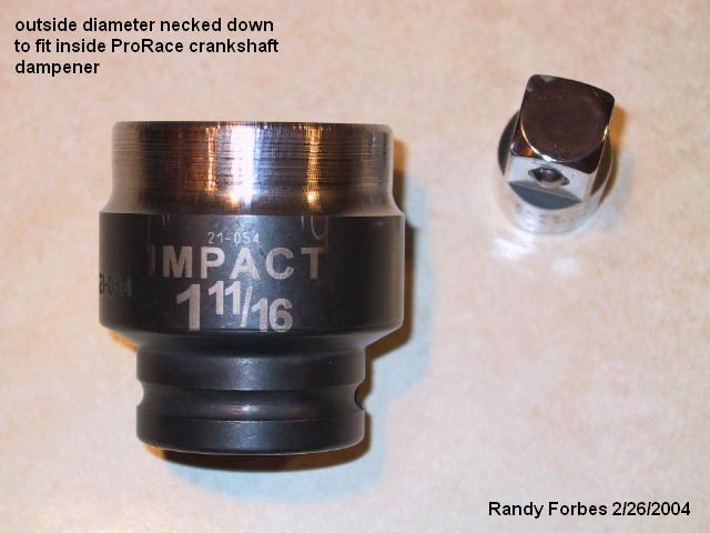

My Northern Tools wrench for turning the crank says 1-11/16"
Well, John, as the old adage goes: "Measure twice and post once!"
My wrench is slightly flared at the tip of the jaws and measures exactly 1-7/8" as I stated above, but in the throat of the jaws it measures 1-3/4". It may be a little bit loose on the nut as is, but I don't think it would fit on mine if it were 1-11/16". I had to file the original wrench so that the jaws would fit at all. I don't think I over-filed it that much. But, as long as your wrench works for you, that's what's important.

I recently bought a 1-11/16" socket to undo my crank pulley. It fits perfectly on my 29D engine.
