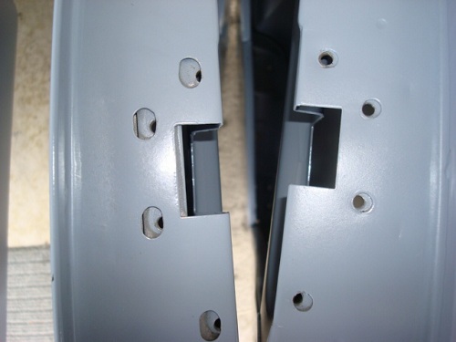

Has any body seen this problem before? There must have been a change in the doors along the way. My doors are the ones without the holes for the handles. If you look at the pictures you will see where the door latch mounts the one on the left is lower than the one on the right.
left door 3 3/4" from the bottom
Right door 4 1/8"
I'm glad I found this now while fitting everything. Not sure how I can correct it without getting another door, or cutting and welding. The door on the left is correct for the car. It's a shame because I have 3 right side doors the are not correct. Does anybody have the door I need? I can trade with you with a rust free door, or I could purchase.

These cars were all hand made. Have you test fitted the doors with the latching parts to make sure it won't fit. It's not unheard of to find variances like that, although it likely is from a different range of builds.
If it is wrong, and you can't find another door, it doesn't look to be impossible to modify to match.
Good catch either way. It would have been awful to find after paint.
Banjo that's how I found the problem, the latch and the plate will not line up. It's at least an 1/4" off. The door lines up fine with the trim line and the top so I know it's not an alignment problem. Yes I'm glad I found the problem now, just another setback with trying to get the car painted before the summer heat returns.

All I can think of is they might have slightly changed the latch height when introducing door handles for the TR3A. Is there any evidence of door handle holes being filled in, or perhaps an early TR3A door reskinned with a TR3 pressing ?.

Check to see if the body shell is correct,first. Measure the door striker holes and see if they are the same on both sides. If they are then you have a monkeyed up door problem. If the shell differs one side to the other{it probably doesnt} then you have a real bag of worms.Body shell was clipped with wrong parts? I hope not.Looking at the two doors,they are not the same[oval adjustment holes and round adjustment holes.Im not sure if the holes differed ,but it would make sense if a change occured at #60001.I never heard of a specific example stating this,but lots of body stuff was changed.If you find a real early TR3 or possibly TR2 short door,your problem might be solved.Working on TRs pre#60000 body shells can be lots of fun. Check you TS#. It's not correct

I agree. (Mine, post outside handles, measure about 4 7/8 from the sill top to the enter of the striker). On mine, the striker is very close to the center of the indent on the b post. Check further the position of the plates inside the doors that the latch screws to. It looks from your pictures like the screw holes for these are off by much less than the cutouts. The cutouts on my spare doors are quite crude but pretty much in the position or your wrong doors. I can find no variation in the b post throughout production (at least post short door) though maybe I've missed something; so it seems unlikely that the position of the latch would have changed.
Hope I'm wrong here but I think I'd be looking at ways to modify the existing door.

Both B posts measure the about the same 4 7/8" left door, and 4 3/4" right door to the center of the striker. They are also in the center of the indent on the B post. I don't think any of the doors were reskined. If I measure from the bottom of door, not the outer skin to the center of the latch button it measures left 4 3/8 right 4 5/8. My problem is in the doors not the B post which is somewhat good news. The only repair I can think of is to cut out and lower the latch area and weld it back in place. It's not that bad of a job just time consuming.

Well, that's reasonably good news. Also, on at least one of my doors, three of the spot welds that hold the mounting plate for the latch, are visible from the outside with a fourth probable. Of course, I'm only guessing that there are four. It looks like one could drill those out, re-drill the mounting holes, move the bracket and alter the slot with minimal damage and disruption. I know the spotwelds often disappear when things get refinished but an alternative just in case. Probably quicker to do it your way but a lot of fairing and finishing, which I try to avoid.

It might be the camera angle, but it looks to me like the cut outs are not the same size and that the bolt patterns are not that much different, at least not an inch and perhaps even workable. What do the bolt patterns measure at center to center of each hole from the top or bottom of the door?

I have 2 pairs of PRE-TS60000 doors. All are short doors, with holes for outside handles. All measure between 4 to 4-1/8" to the cut out. All have 4 round holes for the latch screws -I notice your picture on the left has elongated holes.
