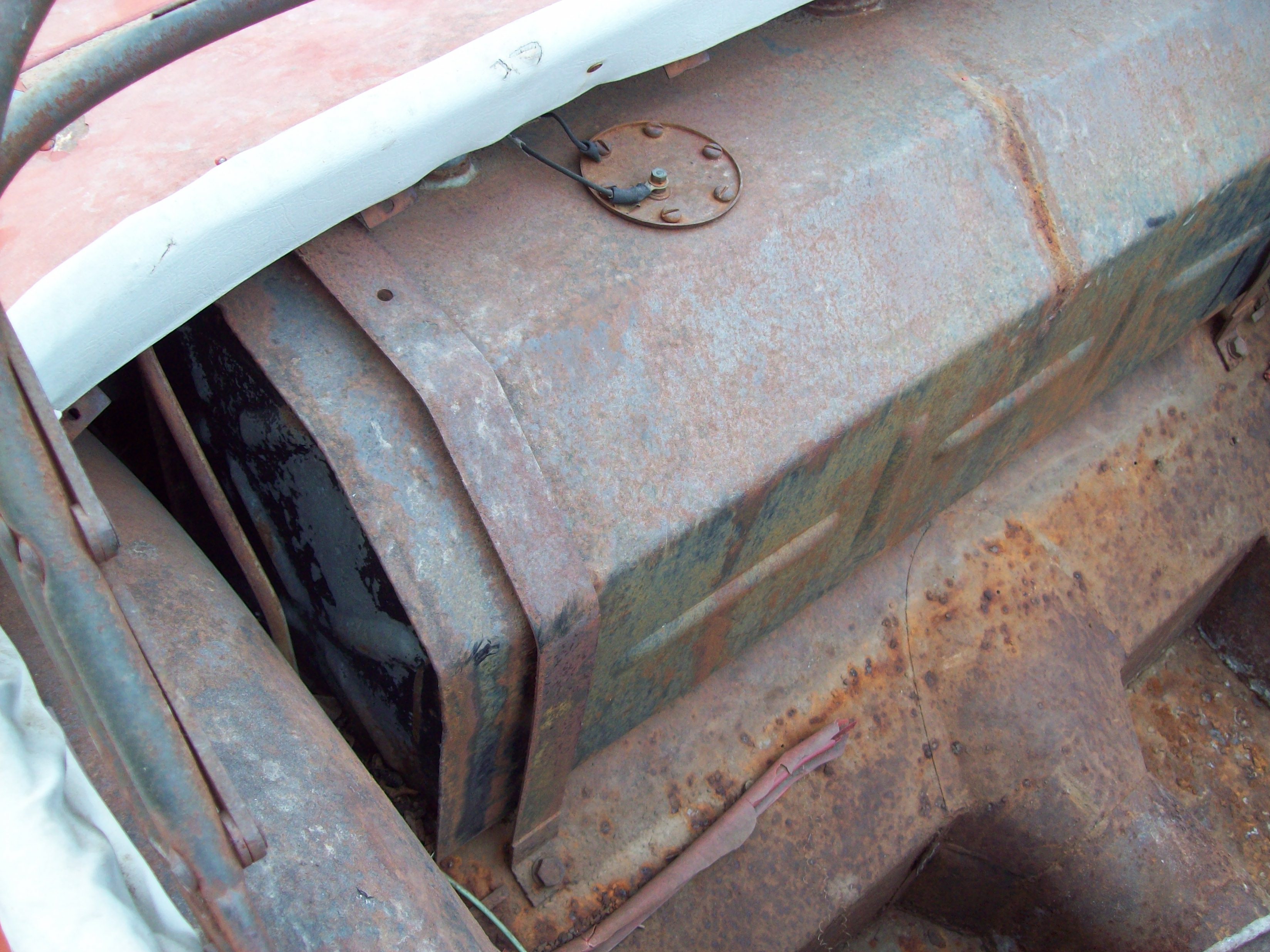

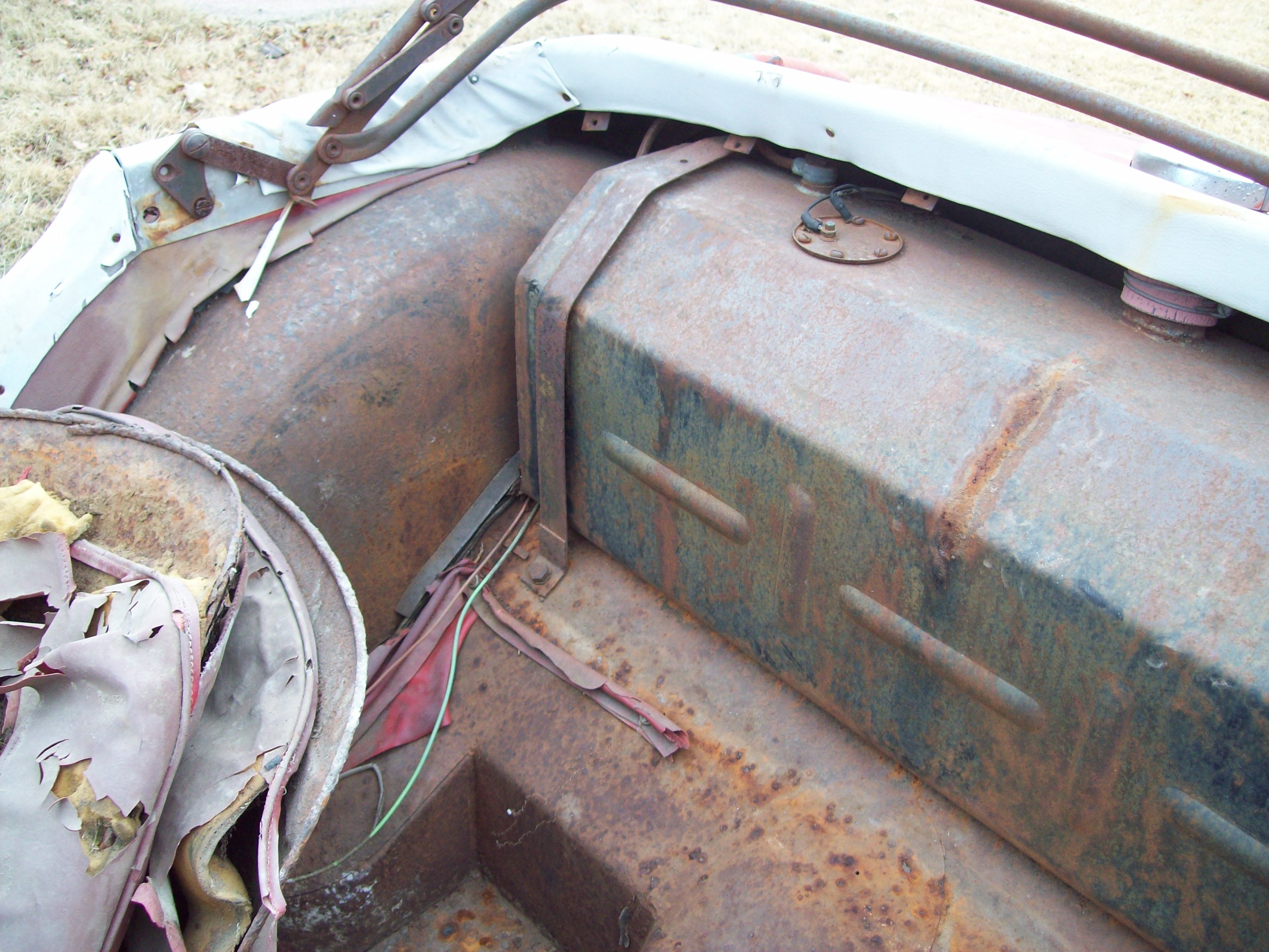

I am looking a picture for what an early tr3 and tr2 used on the back seat gas tank strap to hold the down. I guess the ¼ inch threads on the strap held a stud or a bolt to help hold the seat back seat in place.
Steve

I was hoping some of the newer tr2 guys would know. I am thinking an acorn nut on a stud???Ah, but I had a thought now that the hard top bolts might be used there. I had never seen any of these gas tank straps with the nut option on them.
Steve--- peace out

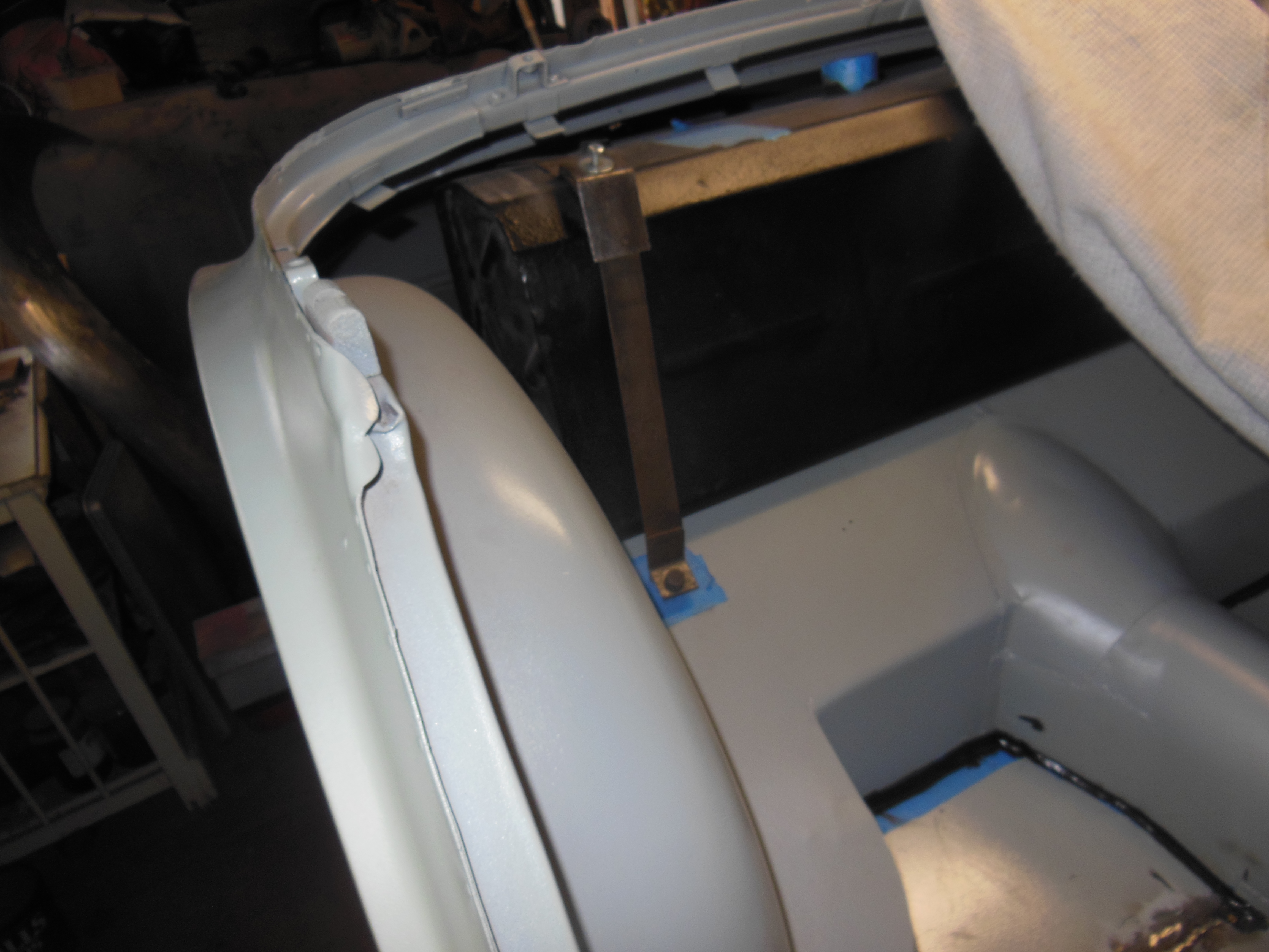

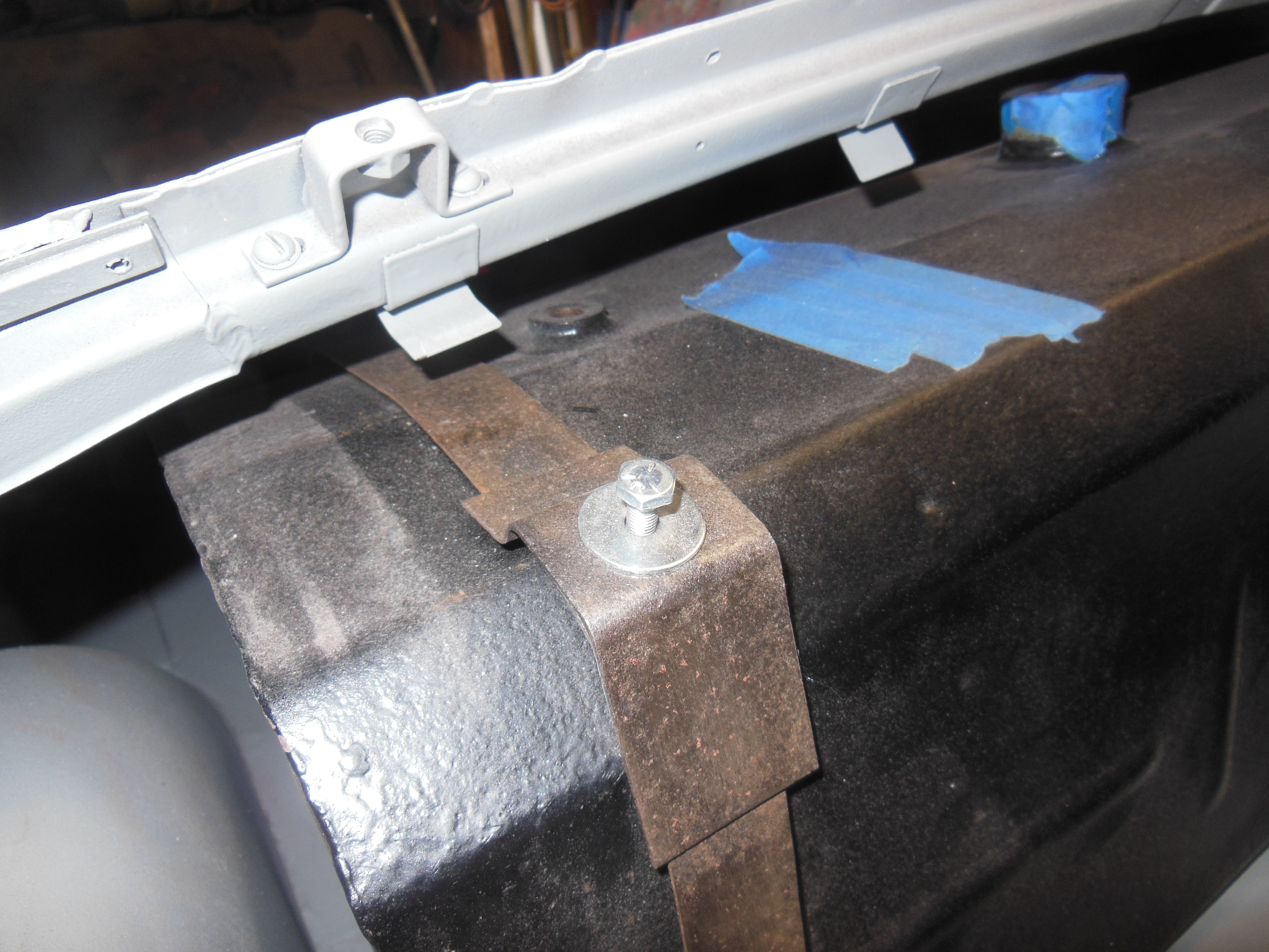

Took me some time to find, but here are a couple from restoration of my early 56 about 15 years ago. Cheers, Mike

It looks like John car has an early gas tank because the upper bend in the sheet metal is longer than mgedit’s gas tank. I threw away the original gas tank that came with my 1955, so no way for me to totally understand the why of the gas tank straps.
