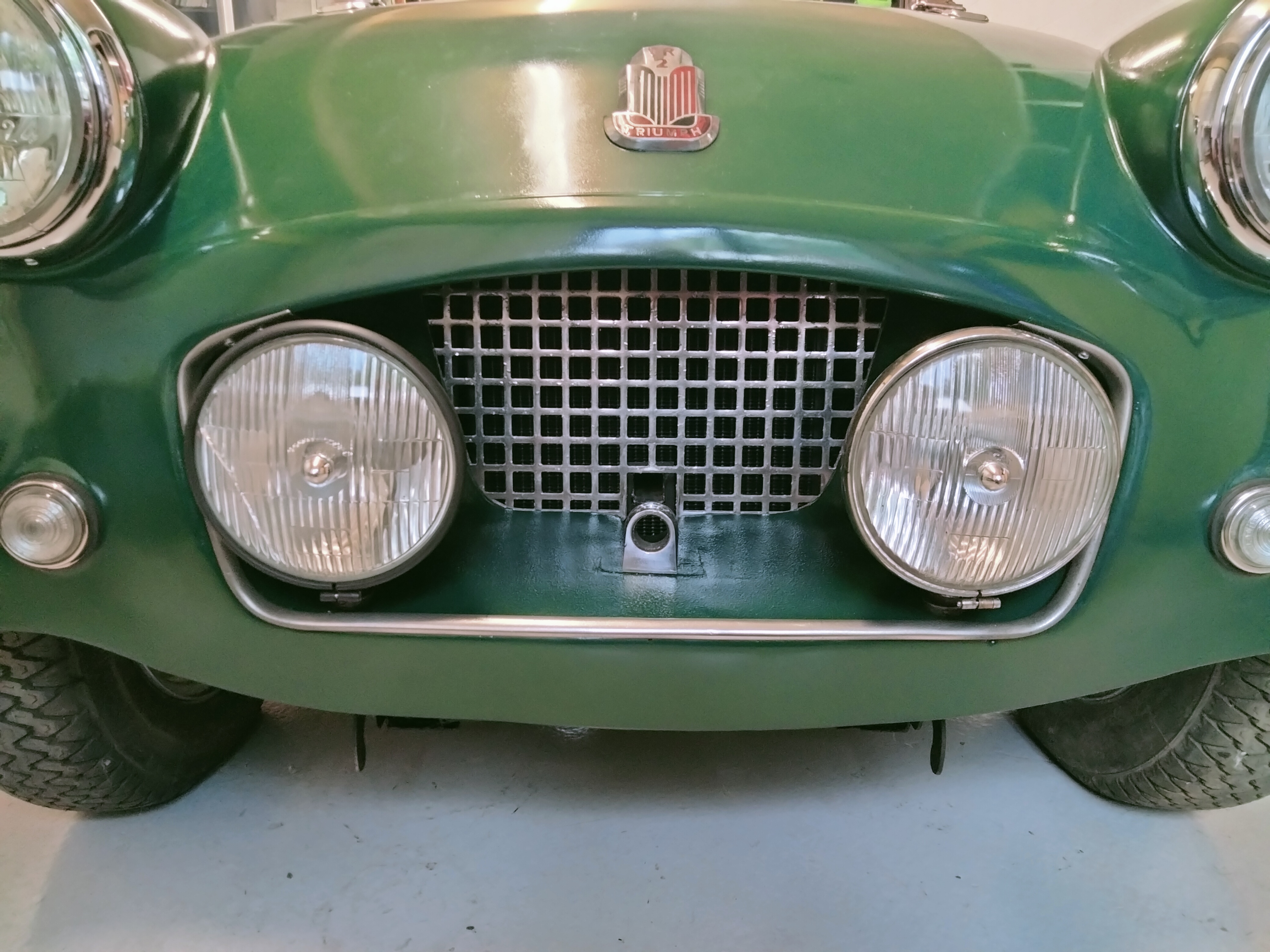

I've always preferred the early cars without the added trim, but then my early long door car never came with it so....
I agree however mine came with trim as the lower and middle holes were in the panel already and contemporary photos show it with the trim in place.
I've now made and fitted the trim.

I agree but the demand is so tiny I guess it's not worth reproducing in any quantity, as with many nla parts for older cars that were made in such small numbers..
I'm quite pleased with my effort though.
I'm saying you can find someone to hand make it, if you really want it. It would be a one-off, not even a low production item. With the Stearman I am rebuilding, I have had to make many one-off hand made parts.
The one you made looks fine to me. It would take someone who really knows TR2's to say it's not original.
