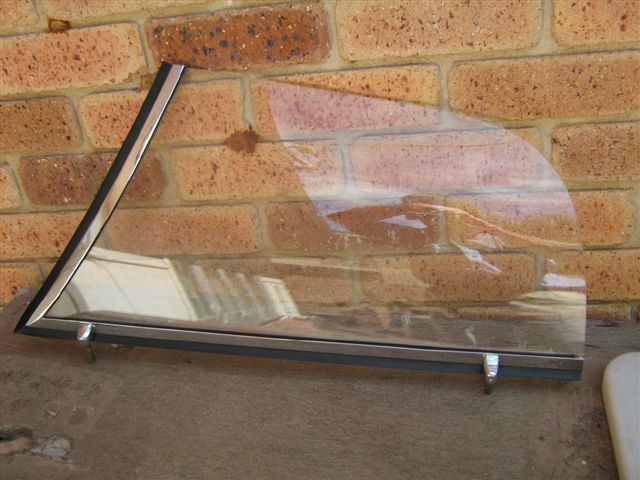

Been remaking my sidescreens as well, these were fitted to the first thousand or so BN1's

A verry good design of Gerry Coocher
and a good works, well done zblu-sure better of sidescreens of the 100/6

I used all new materials, copied my old frames with brass channel that didnt need much machining to match, made a form for the new perspex panels, got the correct rubber bits from a supplier in england and had new pegs cast using my originals to make the molds, then the fun of curving the channel without crushing, and they really do need to be hand fitted to match windscreen rake, pegholes etc, hardest part for me was obtaining some original perspex panels to work with

Very nice work. What is your source for the brass channel? Did you cut it in the middle to run the rubber seal down its length?
Lin
Hi Lin,
The brass section I hunted down actually had the curved edges ready formed for the rubber seal to fit, all I had to do was machine the channel down on two sides and do a bit of routing as well, had to be careful as the brass is prone to snatch!

It was a while ago that I got the channel, I'll see if I can dig up the source, as I am thinking about doing a couple of complete sets up in flat pack form for people that have inquired about them to fit up to their own cars, how much are you looking at?

If your car isn't one of the first 1100 or so then they would not be period correct, be easier/cheaper to emulate the mark 2 version which is basically 1"x1/8" flat bar frame with vinyl/clear plastic with a flap for hand access, they actually seem to work better!
Lin,
If your going to make up some new ones to suit without the curve, I'd get the proper glass cut to suit, as the perspex does scratch easily making viewing out out on a wet night or into the sun a misery!

The shop I purchased the channel from over here in West Oz no longer stocks this, same with a shop over in Victoria, however I still have a couple of sources to check out.
