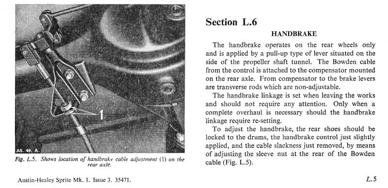

This should help from the Workshop Manual. Bentley has much the same in Section M.3. Dan

Thanks Dan. The Factory Shop Manual isn't nearly as good. Hey you may know this BE. I purchased from John Katz in your part of the world. He got it from the 90 y.o. original owner last year in CA and it has been in storage since. Lots of parts and pieces that I am fixing along the way to make it a driver and then paint will come along with Front Discs, a 5 Speed and a 1275. It's Blue now, no not Iris Blue, but will be OEW with Red Interior. It's coming along just not fast enough. I want to get out and drive. Thanks.
