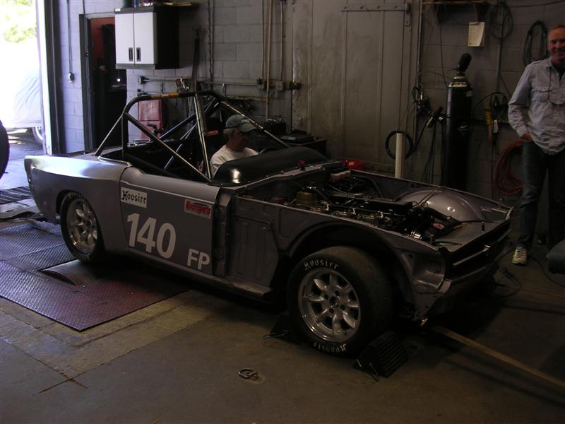

These are the charts from the four (4-5-6-7) pulls. It shows that my HP and Torque came up quite a bit from where I started and that the cam does what it said it would. The last pull was run up to 6,000rpms to check the curve and see if it would climb beyond where the 5,200 peak seemed to be. As you can see, it fell right off, so the TH5 is supposed to have mid range power up to 5,000 and it does.
We did lean out the mixture one quarter turn between runs 4 to 5-6 and decided to leave it alone at that point.
The #3 pull from 2007 is evident as well as the pig rich A/F ratio that was probably part of the two exhaust lobes that were down to 1/2 their starting size.
So here it is:
