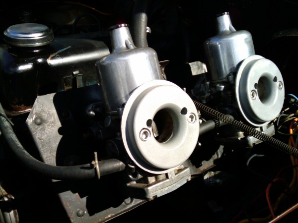

Get an oval port big intake head and a pair of side draft carbs on the thing.
When you pull the existing intake look at the intake ports, if they are small and round then you have the economy head. If they are oval then you are in luck.
Sourcing side draft SU intake manifold is the hardest bit, but intake manifolds for side draft Webers are still being produced (IIRC).

Oh, forgot to include a pic!
