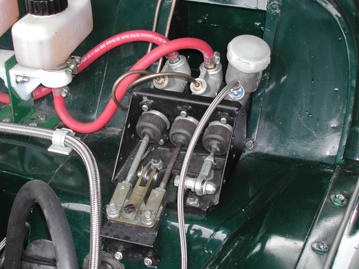

Sorry to jump in so late; I had 'puter problems.
I didn't have a dual brake circuit in my '3 because I had a working hand brake, and this is (or was?) legal in some vintage groups. Never mind that I couldn't reach the handle once belted in.
Anyway, see the attachment for a photo of a dual circuit system using TR parts. The f/r bias is adjustable. Unfortunately, I disremember the car owner, but I can find it out if you want. It's a fast and good-looking TR3.
I am like Bill Dentinger, who says, "The more outside stuff you put on it, the less of a TR3 it is." Or something.
