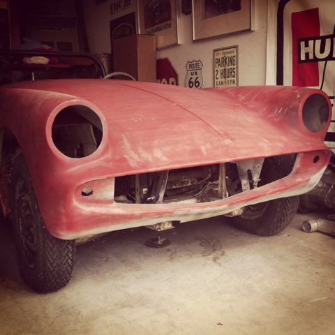

Improving Drum Brakes on the Healey Project. We are building a project for our site TheGentlemanRacer.com and the point is to keep the costs down as much as possible, so the next generation knows they can afford a classic. So far we have scored a lot of great parts and kept our total cost under $1,000 but the car is a 62 with Drums and we have been thinking about trying to track down some discs, but with cost as a factor we were talking about just rebuilding the drums and keeping them for now to get the project on the road and upgrading later. It looks like the only way to really swap it all out is to replace the entire lower control arm... and so far we have yet to find a donor in the local junk yard, plus our junkyard has just raised prices so we would be looking at spending $300 to get the complete assemblies. Is there an aftermarket drum to disc conversion that uses the drum hubs?
