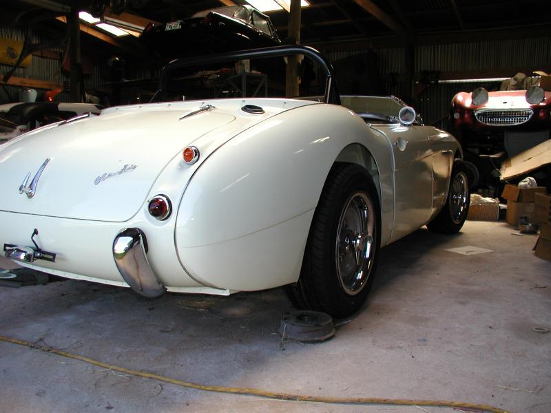

At the rear, I made up these using a surplus pair of bumper brkts. Nerf-bars, similar to what might've been on a period dry-lakes or salt-flats cars (though their push bars were typically in the center; just going for the theme, if not the functionality). These have long since been painted with a deep high gloss black (DAR 9000 for you paint aficionados) and used with stock bumper grommets.

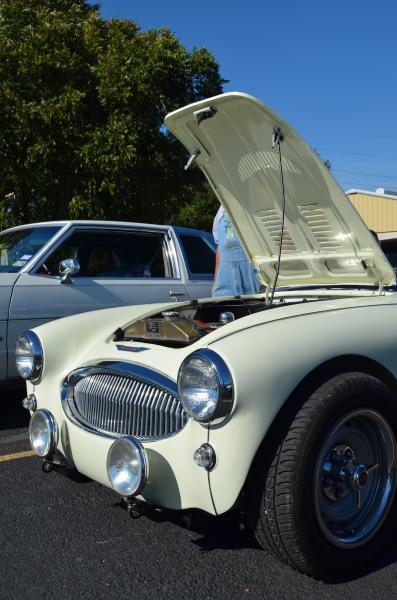

The first photo is of one of the factory mounts for 57 ARX. It uses 7" Lucas Flamethrowers.
My Healey uses a mount similar to the factory mount with 7" Lucas Flamethrowers.
The rear with Sprite bumperettes. Use the rear bumper brackets, cut short and weld on a vertical 1" x 1/8" steel with holes drilled to mount bumperettes.

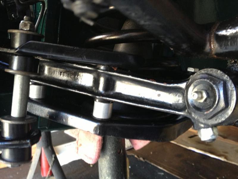

John,
I noticed you, and a few others, have a front suspension that is quite low. What have you done to lower the suspension?
All the best,
Ray(64BJ8P1)
Re: picture posting opportunity!!!
John,
All the best,
Ray(64BJ8P1)
Hi Ray,
We put spacers between the spring pan and lower A-arm:
The spacers shown in the photo are from Denis Welch, and are about 3/4" high, lowering the front about 1". I've replaced them with shorter ones (1/2" nuts) to raise the front a bit to be a little easier on the oil pan.
