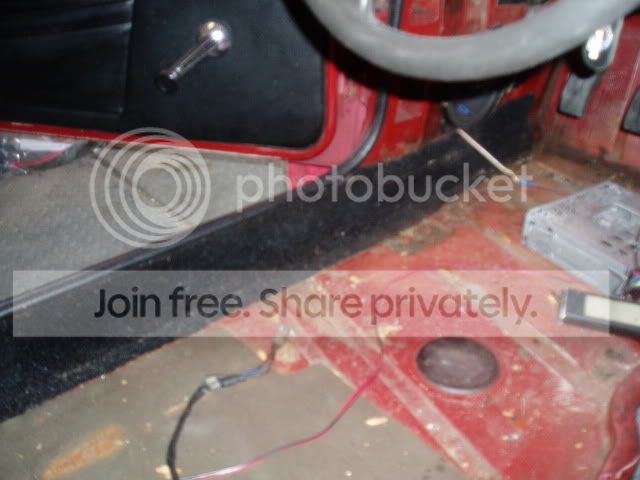

Here's what mine looks like at the mo:
Many thanks!

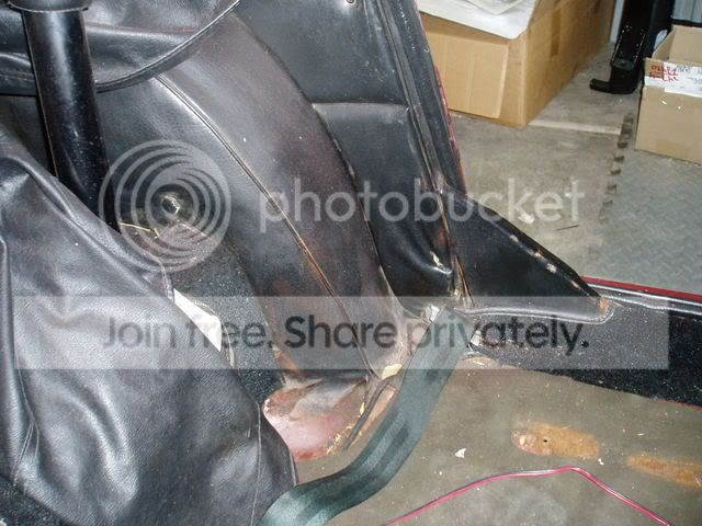

Here's the only picture of the sill that I have. My situation is a little different as I was installing Dan's wire harness and the thickness/gauge of the wire itself made for much larger bundles.
Then I put a split plastic harness over it and the sill carpet and floor carpet covered it all.

So, in my photo, the harness connector block should be positioned in the cavity just to the left?
And the sill carpet glued *over* the harness?
Is that right?
