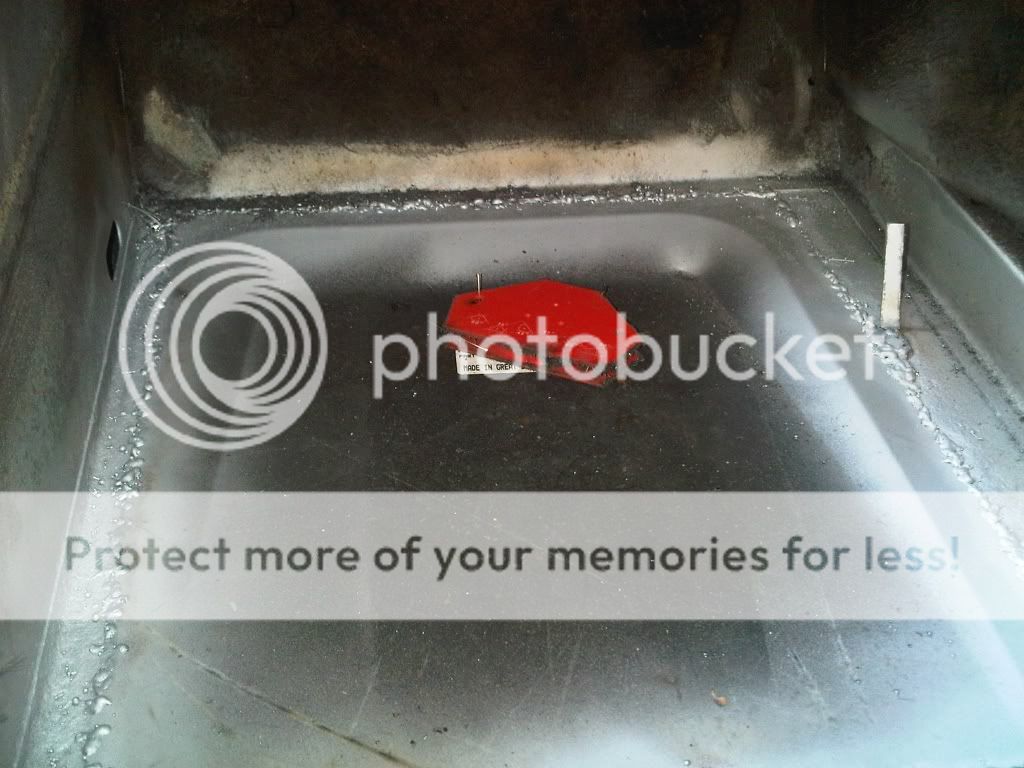

I didn't take many good pictures of the actual welding, will take some as I grind them smooth.
Here is one I did take on my phone, these welds look awful (and they are) but keep in mind I did the welding from below. In other words I did the primary welding from <span style="font-style: italic">under</span> the car in order to make sure I would be able to finish/shape the butt join to make it hard to see that the floor was not original.
What you see here are top welds where I wasn't happy with the penetration and/or wanted to build up an area to help the inner butt weld be harder to see.
Nearly all of this will be ground off, I had to weld in some thin metal on the right side join which is why there is way too much weld there. I cut the panel shorter than I should of, and adding metal back is non-ideal. You won't know that was done once removed.
<span style="font-weight: bold">Remains of floorboard one the part of the panel I needed was cut to approximate size;</span>
<span style="font-weight: bold">Test fitting, note that the panel is not centered in the floor but rather the depression is offset to the left.</span> I trimmed the the panel in order to move it over to the left side more after this picture was taken.
<span style="font-weight: bold">Welded in place, including the "filler" welds which will be ground down flush.</span>

Have to do that to mine also. How did you cut out the old pan?

Yeah, but it will bug me Jack if I don't make it as close as it came from the factory / invisible as possible.
Paul
Hi Paul - I used a thin disk cutter on an angle grinder. Then lots and lots and lots of aggressive wire brushing on a rotary tool to make sure the metal was spotless on both sides before putting on weld through primer.
