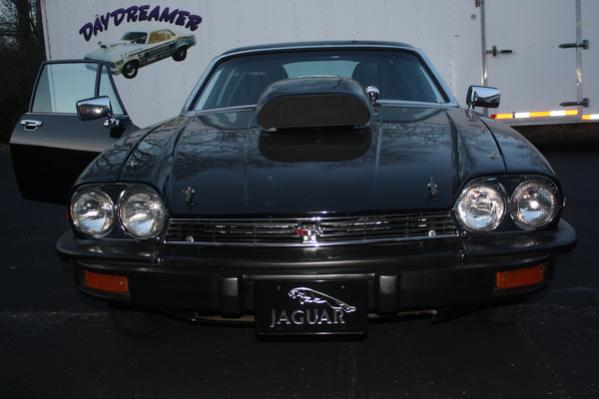

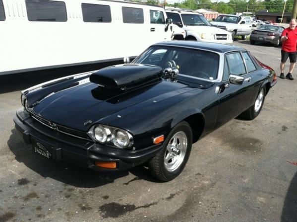

I was asked to post some pics of my 1977 Jaguar XJS coupe Pro-Street...

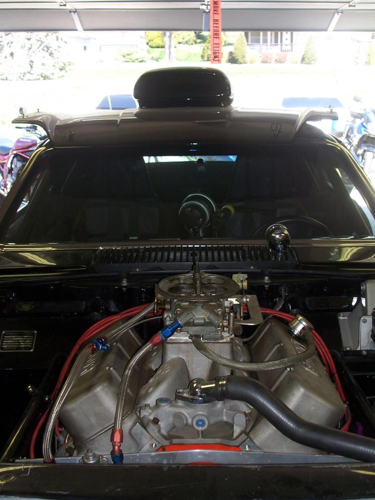

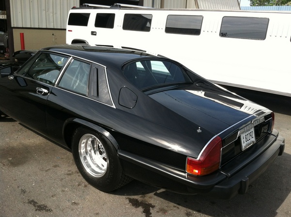

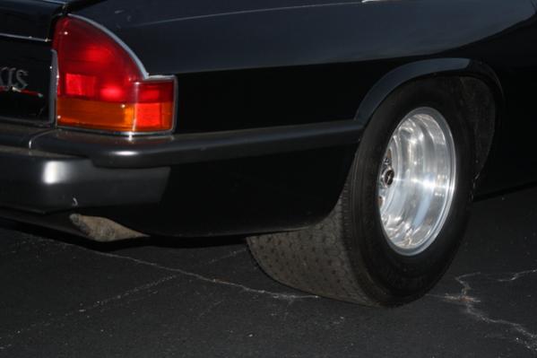

I am assuming you are running a solid axle? If so, are the suspension links connected to a custom tube frame or did you utilize the original unibody?
Original Jag front suspension? Or did you fab something custom to save weight?
in the rear its a ford 9", its a full square tube 2X3 chassic, In the front its a ford mustang rack and struts are after market.. The 2x3 is welded to the original frame under the floors and the rear its all been removed ...I will try to post more pics doing a engine swap putting in a little more pump gas friendly motor. Very Awesome!
