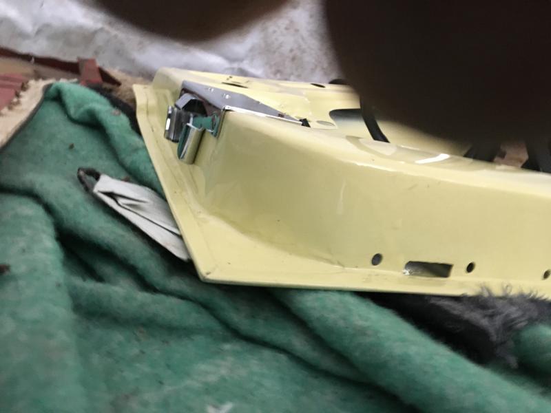

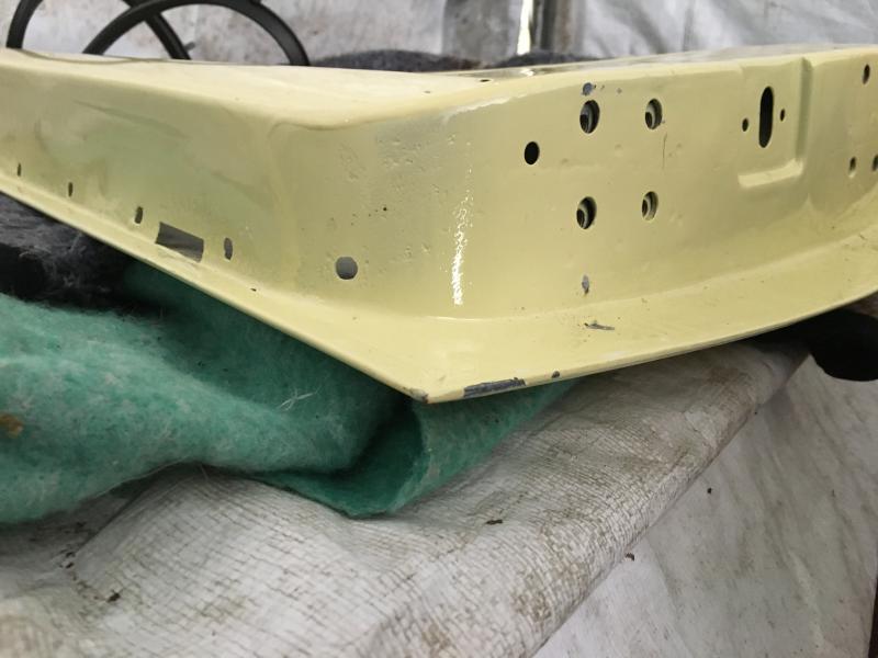

I have been wrestling with the body (TS60014) that was disassembled 25 years ago, and most bits have found logical places, but the draft excluders, so-called, around the door have me a bit baffled. I must have bought them ages ago, and some will have to be replaced with something a bit classier ( Furflex, rather than plain rubber).
On the bottom of the door there are eleven (11) holes for clips but the parts lists seems to call for 14 each side. Should I drill another holeat the back? And should the rubber strip bend round the front end to the hole near the hinge? Photos are of the briber's (wow! that is driver's or LH) side but the other door is the same. That would make thirteen holes in all.
And what happens at the back of the door frame? It looks as though the void behind the striker plate should be filled with the rubber piece that matches the wheel compartment seal, but there is also a piece, same length, that matches the bottom seal.
HELP!

On the early doors, the seal does turn the corner at the front and have 2 more clips on the front of the door. There's also an extra hole at the (square) back edge, compared to your later door. I checked several places and none of them note changes for TS60001, but I wouldn't be surprised if that little detail got overlooked.
They also all seem to say the bottom seal wasn't introduced until TS 5251, and I don't believe that is correct either. The workshop manual talks about the upper seal being "additional water sealing" at TS5251, but that implies there was already some water sealing. But it also seems that the upper seal, and clips for both seals, were never added to the SPC.
Yeah the whole draft seal wind- lace area gets kinda gray. TRF offers a kit for the vertical sides of the doors and it looks good. The early, early stuff was vinyl and later fur-flex; the change point is unclear. The rounded door cars/post60K all had fur-flex. I restored a 1961 once and was surprised how the bottom weather stripping fit; it seemed to leave a big draft at the rounded part of the door. I suggest getting the weather stripping at TRF because it fit nice. Maybe TRF can shed more light on the wind-lace idea. They said it has been unavailable for some time. I made my own draft seals out of pieces I got on line.
