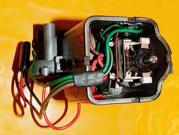

I have one of these 6-wire DR3 motors, it came out of an E-type.
The are just like the DR3A except that they brought the connections from the armature, field-winding and weakening winding out of the case. Thats why there are six wires. On the DR3A they saved wire by joining them up inside. My diagram show how it was done.
The wires on the one from the E-type were in poor shape and I could not even tell the original colors. So I re-wired it inside and it now works exactly like the two-speed DR3A.
I can post a pic of the wiring if you want it. The only thing to watch is that you don't swap the field winding around so that it rotates in the opposite direction. It will still wipe if you do this. But the armature won't get pushed towards the end-float adjusting screw it will go towards the end cap.
Incidentally you can add a "weakening winding" to ANY single-speed motor so as to get a FAST speed. It does not have to be a winding. You can use a resistor.

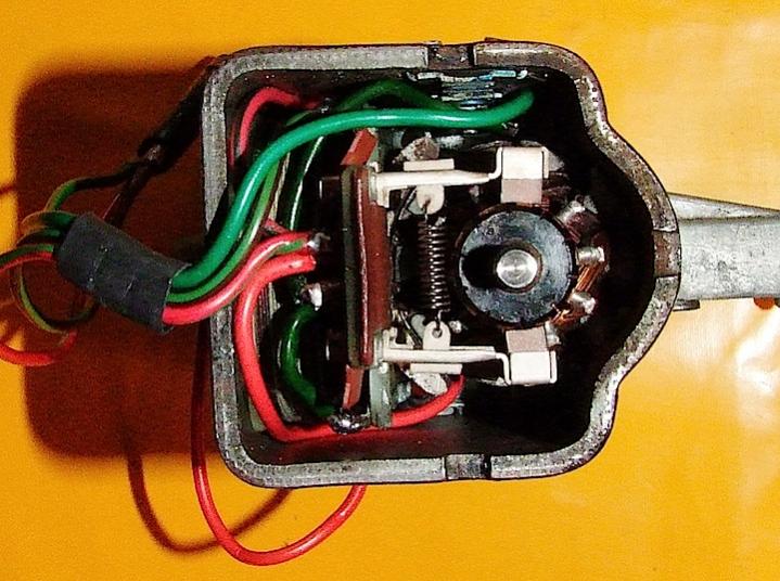

Was a 6-wire, now rewired for use on 4A, wire-colors conform to the diagram in the article on the BCF front-page.
This one has a b-metal overheat cutout on the side wall. This just breaks the 12V feed on the green wire.
Yours may not have this. Mostly Trumph ones don't, but this came from a E-type.
Notice which of the two brushes has the red self-parking wire on it. This also has a wire coming out of the case.
The other brush contact has the 12V coming back from the thermal switch
12V also got to go to the main field-winding, the end that is NOT joined to the weakening winding.
The the joint between the weakening winding and main field winding comes out through the case.
You can just see the light colored "weakening winding". Its only about 10 turns.
This is a simple job if you have three hands.
