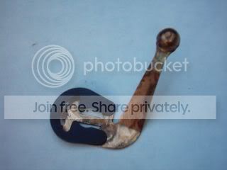

Aha! the culprit has been found. The copper contact which revolves on the circular gear is loose, because the circlip (?) which is supposed to hold it is broken. There's a leg of the circlip missing, so the contact flops around. See pic of broken (?) circlip below.
I wiggled the contact, re-assembled the gearbox, and the autopark autoparked - once. The contact came loose again, and the broken (?) circlip was lying on the geared wheel.
Kerry - do you have the correct circlip available? I think my parking cap is fine - but not the clip which holds the parking arm. I assume that's all that's needed - or is there also supposed to be a washer on that hub with the contact arm and circlip?

I'd have to pull one apart to be certain, but my recollection is that there is only a flat washer below the brass contact, not above it.
I'm pretty sure a hardware store circlip would work fine, but if you'll give me a few days, I'll find the "TR wiper" box and see if I've got a spare original.
Thanks Randall. I notice that with a standard e-clip on the hub, the contact arm is still quite loose. The domed contact point has about 1/4 inch up and down play - that's why I wondered if I'm also missing some sort of spacer or washer.
Interesting how my broken clip is so different from a standard c- or e-clip.
Tom

Glad you got it going, Tom. I did not mean to imply that a standard E-clip was identical to the original, only that it could possibly be made to work. If it takes another washer to make it snug, then put in another washer.
Now that I think about it, the original may have had a tab to engage the slot and keep it from turning on the shaft. I'd guess that the original clips were made to Lucas specification and never available otherwise, but that's just a WAG.

The circlip you need is on its way. There was no washer on this one. I`ll have a look at the other one I have just to make sure. If there is a washer I will send it. But I really don`t think there is. There is no tab on the circlip either, but I am sure that the circlip I removed was O.E.M. {Looks just like your pic, with the exception of not bieng broken}

On second look, there actually IS a washer But it doesn`t go under the circlip. Instead it was located under the actuator arm {on top of the gear}. remove the circlip, remove the brass contact arm, remove the actuator arm. Place the washer on the shaft then replace all components in the reverse order. NEVER FEAR I managed to recover the original package and have repackaged everything and I will send in the morning post.
Kerry
P.S.

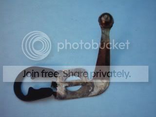

I forgot to mention, placement of the circlip is crutial in order to obtain a snug fit {No slop in these parts}. On the brass contact arm you will observe two tiny tabs protruding upwards slide the circlip over these tabs so that the rounded portion of the clip is contacting the tabs. NOT from either side like you might be tempted to do. If need be I will send a pic of the placement if it isn`t clear to you, let me know.

Tom:
Here are the pics of the circlip orientation as promised for the bennefit of you and others
Pic #2
