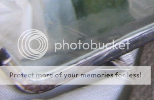

There should be a nylon slider on the rear bottom curve of the channel that actually holds the glass, and you can not change it without taking the glass out of that channel ( from memory). If you do not have one then this should be the main cause.
Photo is a bit blurred but you can just make it out on the left hand side - that yellow looking thing!
I had such a rattle myself but found that the rear guide channel - bolted to the inside rear of the door, had the bottom fixing bracket rusted through so was flapping in the door. Removed it cleaned and welded it up - good as new now.
