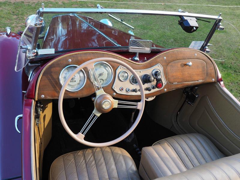

[SIZE=-1]Those who don't know, but those of us who own and know, T series cars have had a problem over the years with the doors opening at speed. Even though my latches fully close with the pin fully engaged, I think about this problem on our cars all the time, especially on the passenger door where my wife sets. To ad a little more safety I ordered a pair of these stainless marine latches to install on the lower part of both doors. 15 bucks each is very cheap insurance. I'm also installing seat belts.[/SIZE]:encouragement: PJ

I have something similar on mine -- they're more like a slide bolt but they're chrome and look fine. You can barely see it in the picture here
