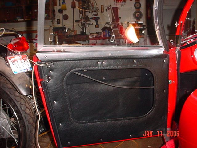

Sorry you are not getting answers. As I understand your question, you want to know how far the upholstery trim panels overlap the metal inner door openings. I can only speak for my BN2 which is somewhat different than your car. At least it may serve as a starting point for further discussion. Attached is a pic of my door panel.
The trim panel edge overlaps the top metal edge by 1". Overlap on the rear edge is 1 1/4". Overlap at the front is 1 3/8". Overlap at the bottom is 4 1/2" which forms a pocket to store junk. Corner radii are about two inches. I think your panels might have a wider diagonal edge at the upper front opening rather than a radius.
Note that there is a row of coarse stitching around the inner opening that is sewn completely through the covering AND the backing.

Many thanks to John and Dave. I do have the Moment book and the Moss cat., but I couldn't figure out the sizing. If I guessed I would have missed the the overlap at the bottom that creates the "pocket". I should be pretty close to "real" except for the stitching on the panels and possibly the "step" on the forward edge. Not sure about that, yet. Bob
