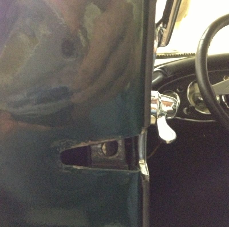

I need some help with the alignment of the door latches as mine don't seem to have enough adjustment to get them to close flush. Either I need to slot the holes in the body and move the striker outward or I need to cut-n-shut the bracket that holds the latch in the door to move it closer to the inner side.
Note the approx half inch gap between the latch mechanism and the inner door frame. Is this normal?
The gap is caused by the length of the bracket legs which I could cut and weld to bring the latch closer to the (table in this pic).
Thoughts please?
Andy.

The problem I'm having is that my striker on the shut pillar is adjusted outward as far as it will go but the 'shut' position is with the door too far inward. I can't move it out by moving the striker as would be the normal way because there is no more adjustment left.
The curious thing is that it has been like this for the last 50 odd years...
I'd appreciate if somebody could post up a pic of their door latch showing the gap or lack thereof so I can hopefully understand what is not normal on my setup.
Andy.

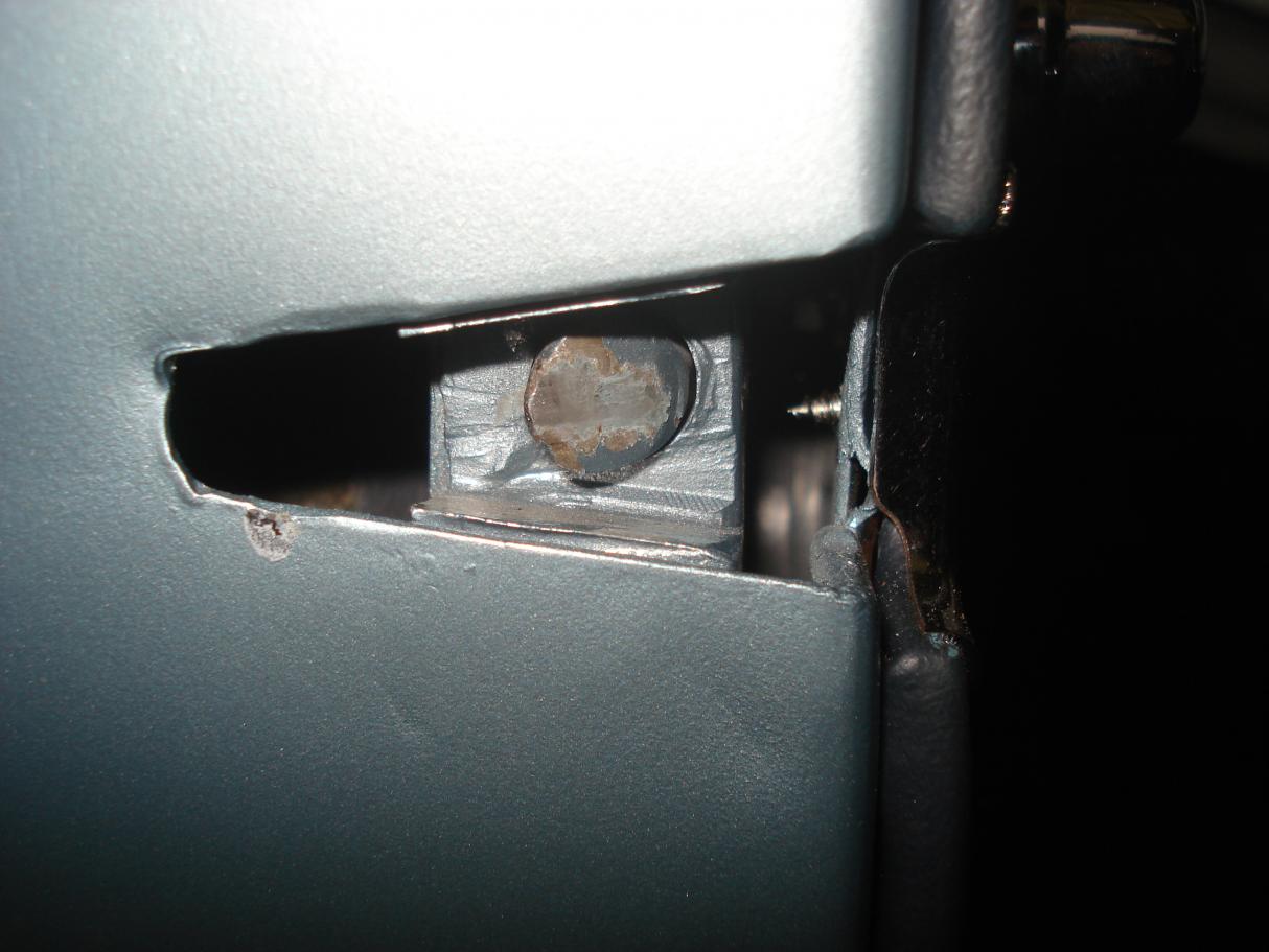

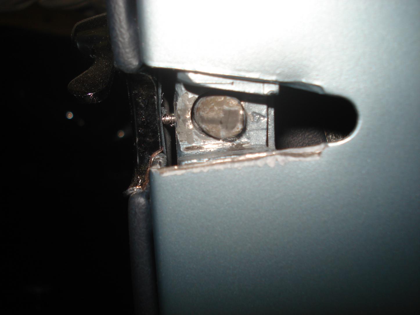

Like John mine also have that gap. My doors were able to adjust and the doors are original and needed no rust repair and the shut pillars are also original. I did need to enlarge the holes in the shut face aluminum panels to allow enough adjustment. I also made the mistake of not realizing in which notch the door needed to fully close into. After I figured out the pin wasn't going all the way into the hole the adjustment went fairly easy.
Jim

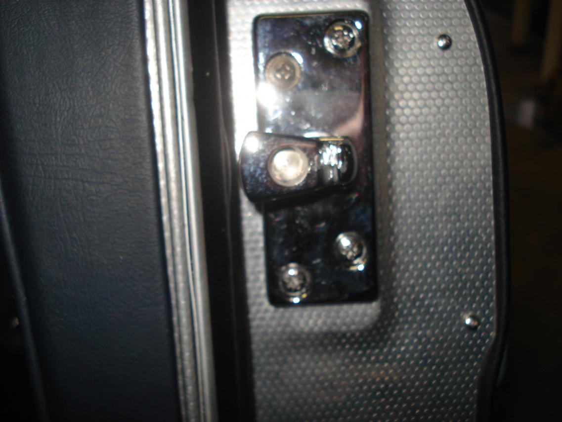

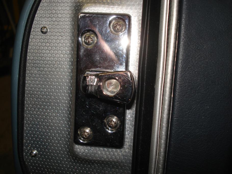

Here is the striker side so you can compare how mine are adjusted in relation to the door seal edge, and how you have yours adjusted.
JIM
