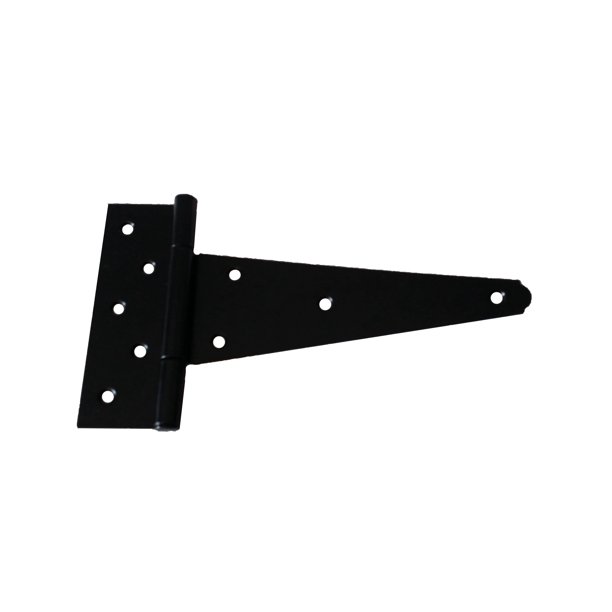

I'm trying to put an outward-opening door on a shed.
The door frame is double 2x4s, but the wide side of the 2x is facing the door opening, and the "narrow" side of the 2x4 is facing outward. I'd planned to use simple T-hinges:
I don't want to screw the door hinge into the narrow side of the 2x, as it would risk splitting the wood.
What kind of hinge can I find, that screws into the "wide" side of the 2x4, instead of the narrow side, and still allows the long part of the hinge to swing the door outward and toward the side of the shed?

Thanks for the suggestion. I can see that working perfectly if I use a standard rectangular door hinge.
but my brain can't get around how that would work using the T-hinges I bought, due to the position of the hinge pin cylinder relative to the two hinge wings; cylinder prevents door from fully opening. Reverse the hinge, now the door won't fully close.

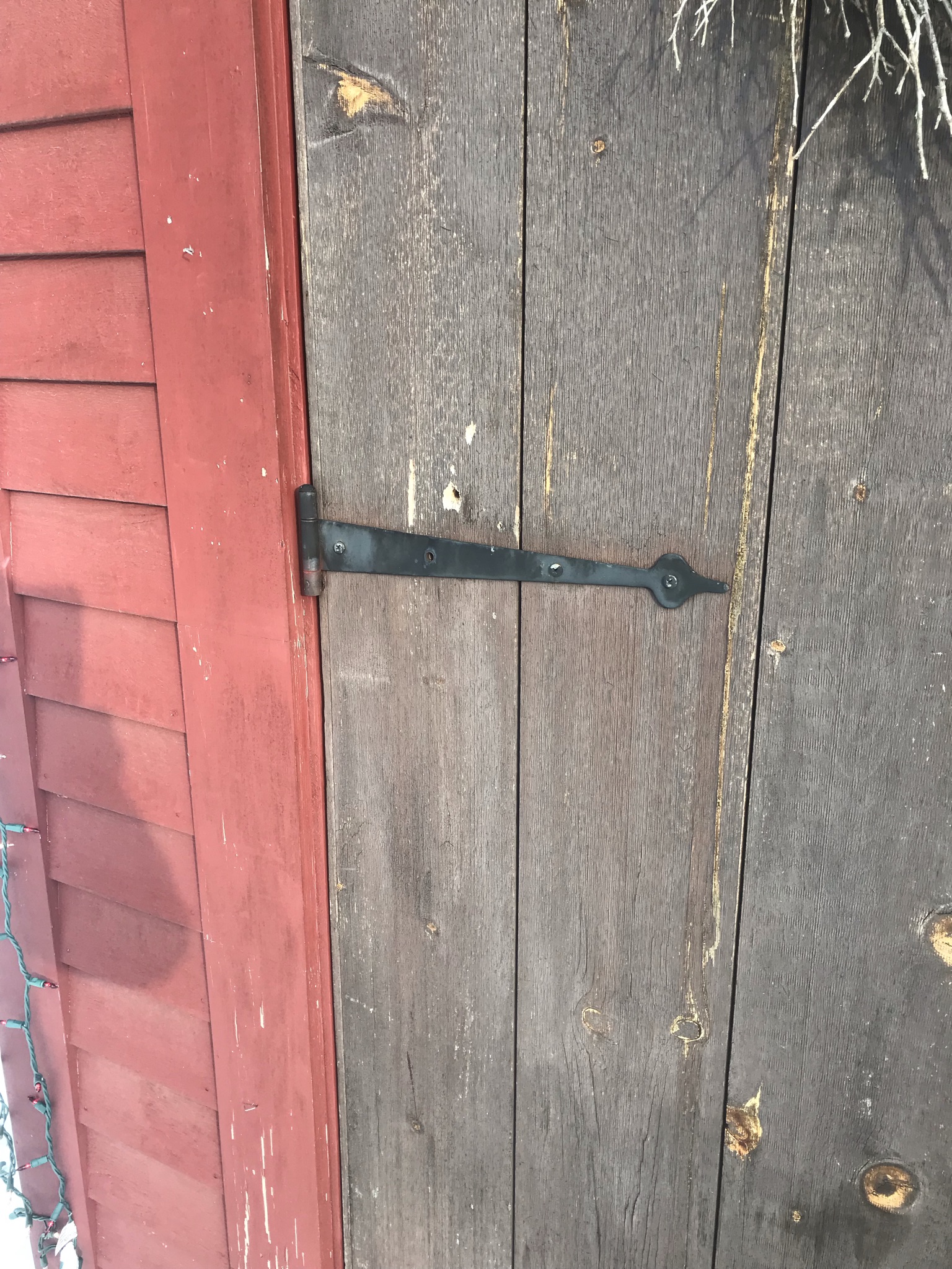

That’s how I did it when I built my shed. I think you will figure it out. Here’s some pictures of mine. Also of my trek through the snow. 31521C9C-87B6-4E3F-BB32-05E6F0A558BC.jpeg

That’s how I did it when I built my shed. I think you will figure it out. Here’s some pictures of mine. Also of my trek through the snow. View attachment 74949
That's exactly what I want to do. Did you chisel out the mounting spot on the frame?

I didn’t mortise them. I just surface mounted them. The door hinges in your house are designed to be mortised in otherwise the gap will be too large. Since you are surface mounting the strap you can easily set the gap. We got 10 inches in RI.
